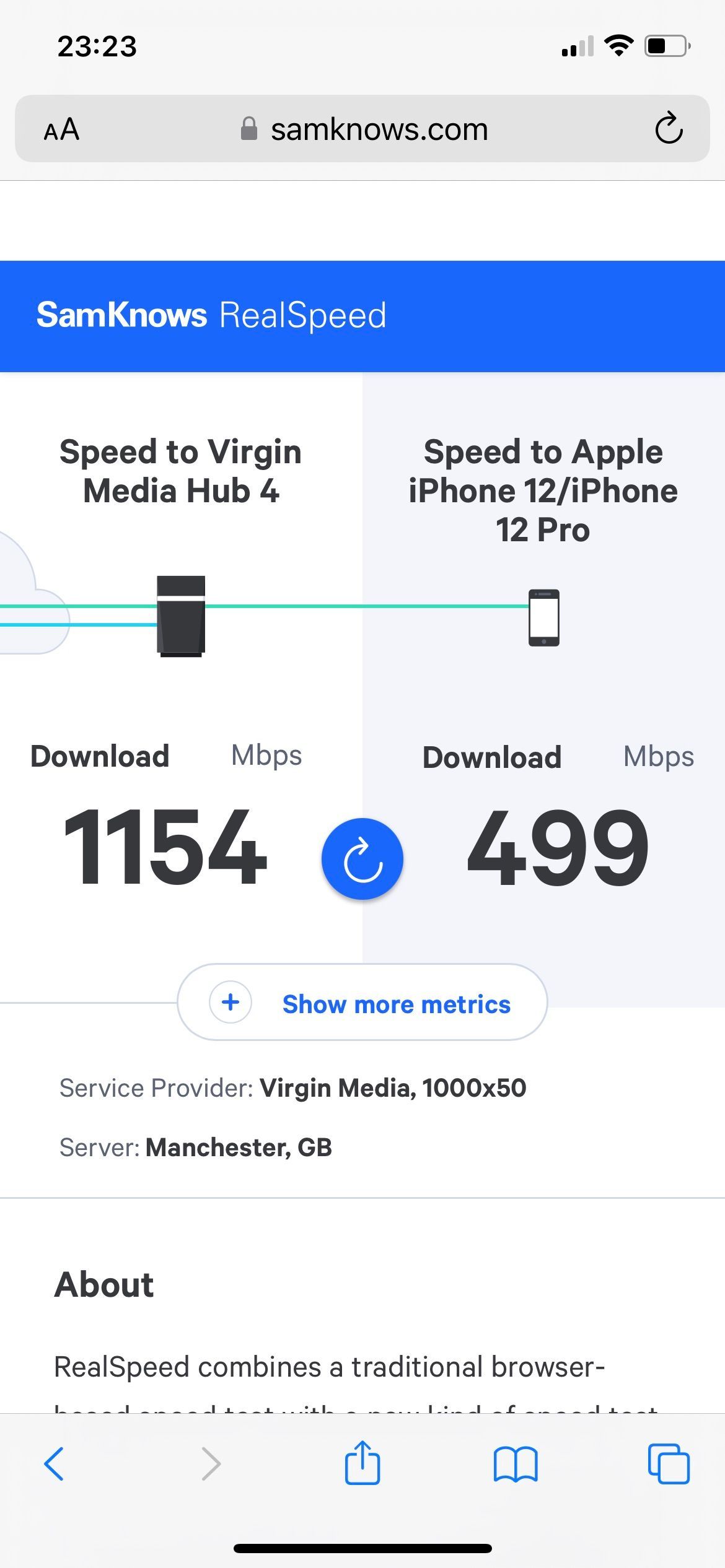

I am also having a similar problem to this. I have recently joined Virgin Media and have the 1GB broadband service (1000x50). When I run the SamKnows speed test (on WiFi or Ethernet) I receive around 1154Mbps Download to the Virgin Media Hub 4; but only around 500Mbps to the device. An example device is my Apple iPhone 12 Pro; but I have also tested with a year old Dell i5 laptop too.

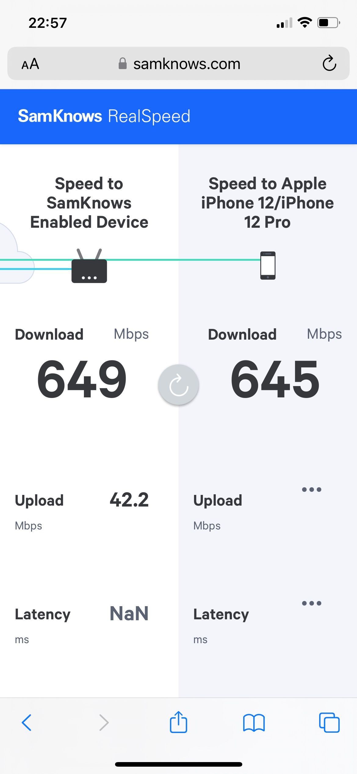

The strange thing is my Dad has the slower speed connection at his house (600x40), and when I did the SamKnows speed test on the same device there (on my iPhone 12 pro) I was getting 649Mbps Download to the Hub (he has a Hub 5, but previously had a Hub 3) and 645Mbps to the device. Therefore I'm getting a higher download speed but on the lower tariff.
I have tried to keep my testing the same (e.g. similar distances to the router), both were done at night last night.
I have tried to check/work through some of the other suggestions on some of the posts, but I couldn't see anything obviously wrong in the config. Does anybody have any advice to increase/resolve this?

Thank you for coming back to me. I have followed your additional suggestions of disconnecting all other devices and only connecting the laptop via Ethernet, but unfortunately I am still receiving similar speeds of around 500Mbps.
What else can we do to resolve this?

As we can see in the image you provided the correct speed is hitting the Router, if your device isn't this will be a device issue, does the laptop have a gigabit network card inside, is thee Ethernet cable a Cat 6 or above.

I don’t believe that it is a device issue. If we put the laptop aside for the moment; my iPhone 12 Pro achieves the same speeds on wifi, however on my fathers virgin connection (600Mbps) it can achieve the full 600 speeds.
Fathers:Mine:
