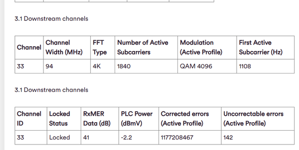

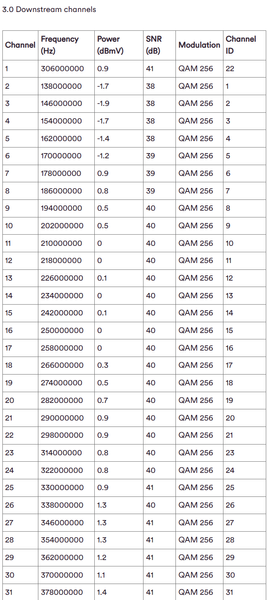

Recently i have been getting my internet connection dropping out randomly i checked all the cables etc but nothing was wrong there.
The modem log show this -
Mod Edit - Personal information removed
6 Replies
    Too many PostRS errors on your Downstream channels.  Could be indicative of "noise" ingress on the circuit.  One for VM tech to check and fix.  A good circuit should have zero, or close to, PostRS errors.

    Over the last 12hrs ive had 27 entries in the modem log of these errors  " CM-STATUS message sent. Event Type Code: 16; Chan ID: 33"  and " CM-STATUS message sent. Event Type Code: 24; Chan ID: 33"
