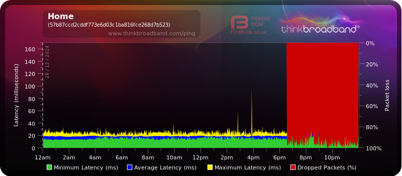

    That BQM trace is very unusual, a solid block of disconnection but including some fast responses getting through.
