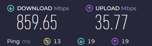

Having issues with broadband over the last few days getting massive lag spikes in multiple games. Speedtests are sporadic one moment it looks ok getting over 900mbps(normal with 1gb ethernet) with 105mbps upload then after a spike check again and its dropped to 600-700mbps with upload at 50-60mbps.

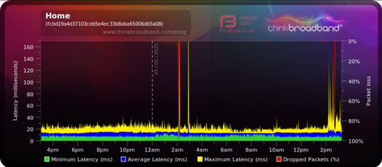

Todays BQM

  • Still have the issue intermittently.
    Speedtest at time of writing this post.
    Also link to live graph
    https://www.thinkbroadband.com/broadband/monitoring/quality/share/333baa61220181d9e36f35cb2b3aef0a50c8099b

      From checking the account, we can see the download speeds at present are averaging 1097Mbps and upload is showing as averaging 102Mbps, there has been one disconnection in the last five which is an improvement on the previous week.
      But checking the levels, there is some issues with the downstream power levels which will require a visit. I will send you a Private Message, please keep an eye out in the top right when signed into the forums for the envelope. This is where you will be able to find my Private Message and be able to respond.
