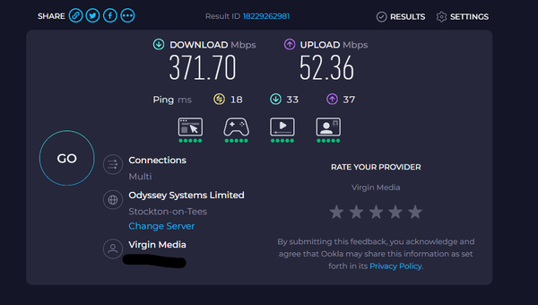

Speed test when the connection is stable: about 527 Mbps down, 52 Mbps up, latency 14 ms, jitter 1–2 ms, packet loss 0%.

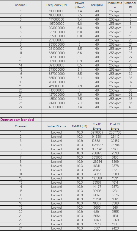

    Readings from tonight.
