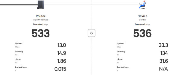

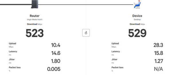

I just tested again..
It's not 50mbps upload but it's not unsuable??? So why do I lag so much and have ridiculously high ping in games and calls. Ping spikes to 500-1000ms back down and up and it's stable throughout random times in the day. It's not just one game its all games. Testing on my phone and the uploads are the same download speed is less but I use my PC more.
This is a screenshot I took one night 15/05/2025

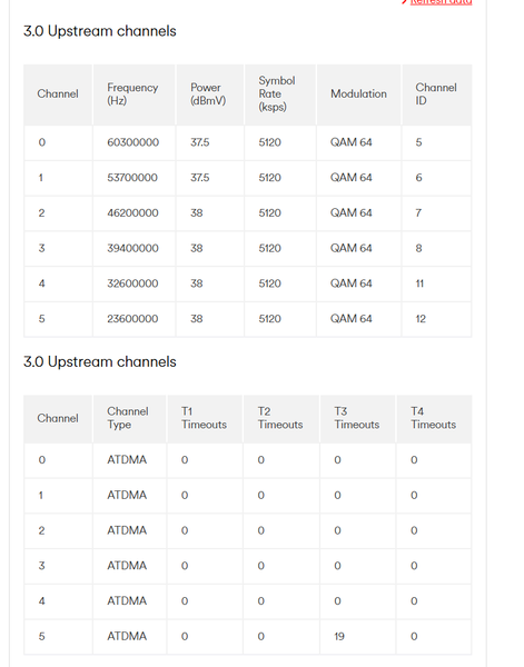

Live chatted with someone told them everything and they just sent another engineer.. Told them about me realising that there are T3 Timeouts on Channel 5 (if that had anything to do with it) The 19 timeouts racked to 25 the day after this screenshot where the engineer had visited.
Engineer told me they cleaned the cables . Told me it's rare but it might be feedback coming back into the router from my ethernet cable.
Just checked again and my channel 5 T3 Timeouts is now 1 after they visited.

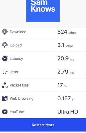

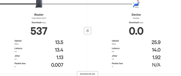

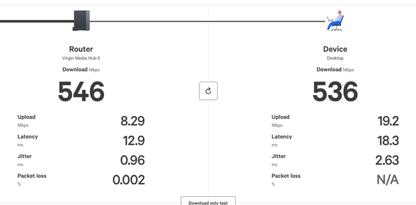

    The results from the Realspeed test do look suspect especially where the speed figures at the Hub are less that those at the Device.
    Samknows Realspeed is also available as apps for Android and iPhones.
    See if these give same results.  Over Wi-Fi I focus most on checking the service speed at the VM Hub as expected, for the Wi-Fi devices the figures will vary.

      This is a test on the app with my phone right next to the router/modem
