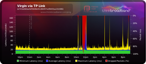

I've been on M500 without much issue for approx 12 months until earlier this month since when I've regularly experienced some fairly prolonged periods of the internet being unusable - typically 30 mins but sometimes 12 hours+.
During these times the internet is not completely down but requests for web resources typically will timeout.  The issues coincide with "SYNC Timing Synchronization failure" error logs and very high packet loss according to BQM tool - for example here is my BQM for past 24 hours.
During these sync issue episodes, the online network status tool will sometimes acknowledge intermittent signal in your area, but sometimes no problems found.  The automated line checker phone service does not seem to ever acknoweldge a problem.

      Thank you, the engineer visit seems to have resolved the issues.
      Regarding my original question, id add that it is still not clear to me how i obtained the engineer visit.  I was prompted that an engineer visit was required after running an online status check and scheduled it online.  What’s strange is i have used the online status checker many times before this while having the same issues.
      • Carley_S's avatar
        Carley_S
        Great to hear that the engineer resolved the issue for you.
