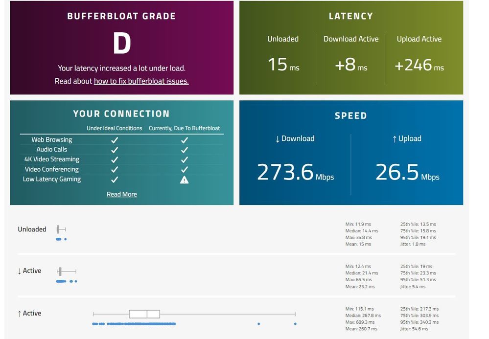

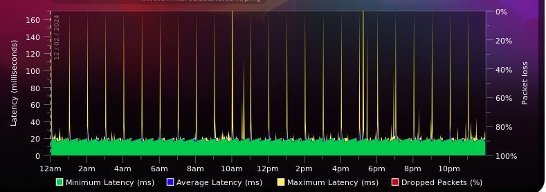

So I've been on the new GSX-PON FTTP (Fibre to the Premises) connection since October. The first month and a bit was fine with no issues however since at least November I have had issues with latency spikes noticeable when gaming. I set up a Broadband Quality monitor and have also been running various latency tests and it seems that my broadband consistently had a pattern of peaking to very high latency and also when in use and gaming more of these latency spikes occur. I'm not talking spikes to like 60ms, I am seeing spikes up to well over 500ms.
On the tests I run the latency on download is fine however on upload most of the time it will see an average of around 150-350ms latency. On the rare occasions, I do see this stay around 20-40ms on tests but I'd say 90% of my tests show over 200ms on upload latency.
This seems to be down to bufferbloat however there is nothing I can try on my side to sort this out as the Hub 5x cannot yet be put into Modem mode so I can not buy and use my own router with some SQM to help stop bufferbloat. However, that is beyond the point as my old ADSL line never had these issues and there was no special SQM on that. I should not need to buy a router when this is not acceptable broadband that should not be having these issues.

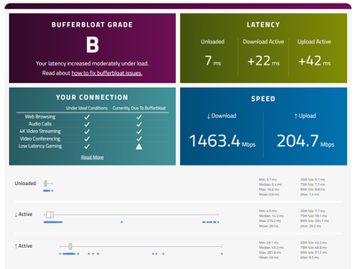

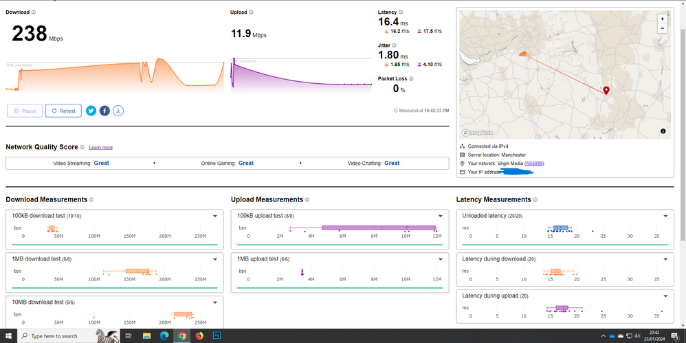

I've included examples below with also the rare good test I actually got to prove that it isnt just the test bloating the network as sometimes it has perfect upload latency but only 5% of the time I test it. If that.

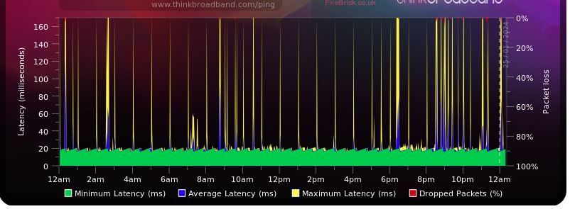

Broadband Quality Monitor
Bufferbloat Test

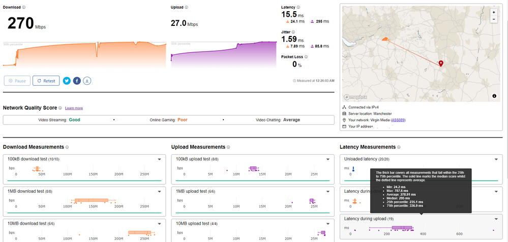

Cloudflare Test 1
Cloudflare Test 2 *This is what I get the majority of the time*

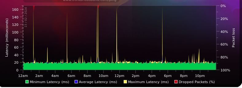

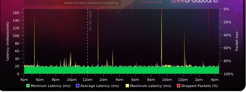

    So an update on my situation.
    After I was ill for the last few weeks earlier this week I started chasing this again and making phone calls. (Going through the very annoying automated service time and time again to speak to an actual human myself) Anytime I get through to the Indian call center they are quite frankly useless both call operators and managers and also struggle to understand half of what they are saying.
    However, I eventually managed to get through to the English call center and I explained the issue and that if they could stop doing these period speed tests to my Hub 5x every hour then it would probably sort most my issues I am facing. I was told that they don't think they can stop the tests but he said he was going to ask and find out.
    I notice that my lag when gaming only really occurs on the hour such as 20:01, 21:01, 22:01, and so on. This is obviously when they are doing the speed tests.
    I also booked an engineer to come out again which was a few days ago, he saw the issue and spoke to a network engineer and he confirmed there are speed tests every hour which VM are doing to these hubs on the new XGS-PON network. This network engineer also said that most of these issues would be sorted if Modem mode was available as it stops all the VM tests etc.
    I checked my BQM the day the engineer came to visit and long behold, after I got off the phone with the English phone operator the other day who said they would ask if the tests can be stopped they seem to have stopped testing my hub so often, maybe at all. I have not experienced the lag on the hour the last few days as well.
    Now whether this is a massive coincidence or not that they seem to have stopped testing my hub I don't know, I never got confirmation that the tests have been stopped but see my BQM from the days before I called up, on the day I call up and the days after and it is a massive difference.
    Now this doesn't fix the buffer bloat issue so whenever I speed test I get bad upload latency on the tests due to the saturation of the upload, but at least VM doesn't seem to be saturating my upload anymore every hour with their own speed tests. They still need to enable Modem mode on the Hub 5x so I can sort and manage the buffer bloat and upload saturation myself with my own router but at least for now this is a big help and a massive improvment than before.

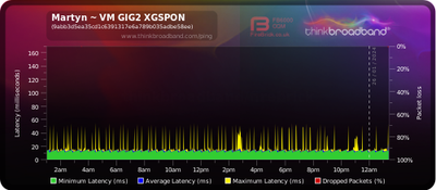

      • Martyn's avatar
        Martyn
        Superfast
        Yes all blanked out, re-adding here, (they still showing above for me)
        added below works fine. (maybe)

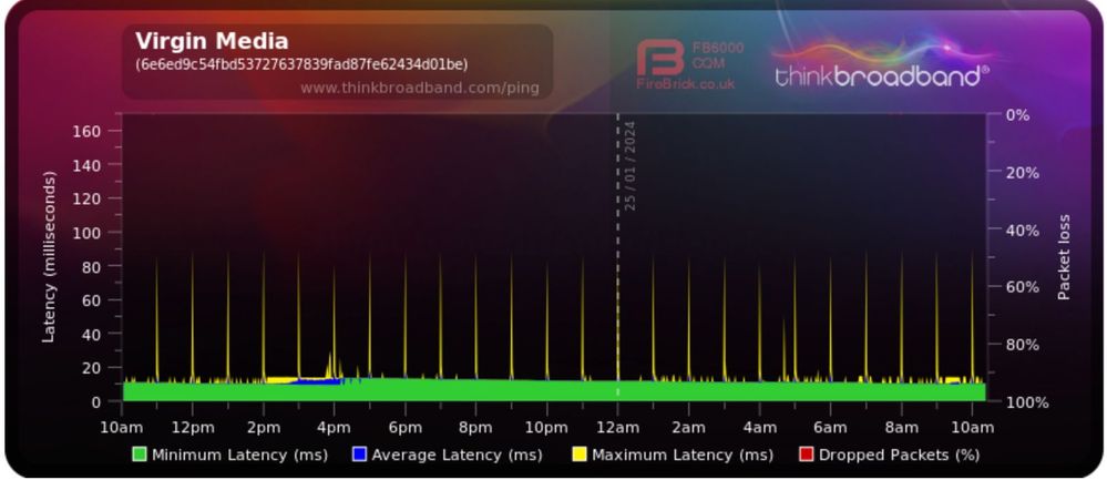

  • pob42's avatar
    pob42

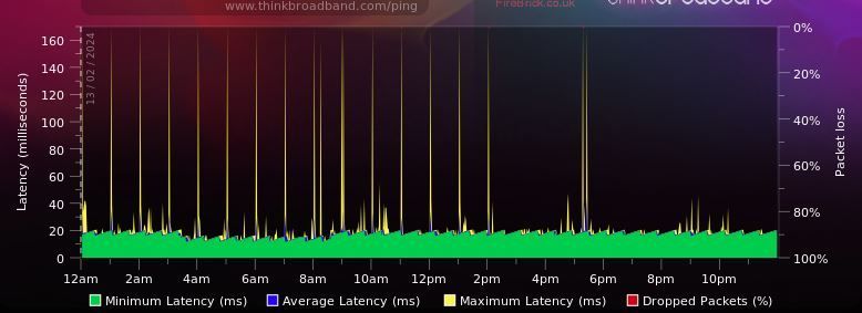

    Here is my BQM on the 1 gig service with 5x Hub (very little internet use for the last 24 hrs)
    • harveyl12's avatar
      harveyl12
      Looks miles better than mine, Your spikes when virgin media seem to do a test don't peak anywhere near as much as mine do.
