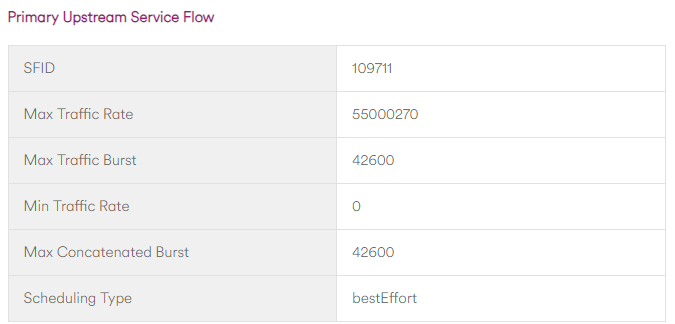

Hello, I am in area 22 and have the Gig1 package which as I understand has had it's upload speed increased from 52mbps to 104mbps.
If I run a postcode and address check on VM's website checking availability, the Gig1 package is advertised to my address as having an upload speed of 104mbps, which has not taken place on my equipment yet as an existing customer. I have tried multiple hub reboots and reset to factory defaults with the hope that it would force a config file update to be pulled. My hub's configuration status page shows the upstream Max Traffic rate still at the same 55000270 which I would expect to double once the change takes effect.

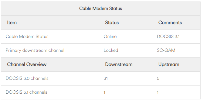

    To be able to reach 100+ Mb/s in the upstream, the Hub connection needs ...
    At least 5 and preferably 6 upstream 3.0 DOCSIS Channels.
    OR
    4 upstream 3.0 DOCSIS Channels and 1 upstream 3.1 DOCSIS Channel

    I indeed do have enough upstream channels, but what is not adding up is the "Max Traffic Rate" of 55000270 on the Hub's configuration profile matching the expected value of 100mbps+.

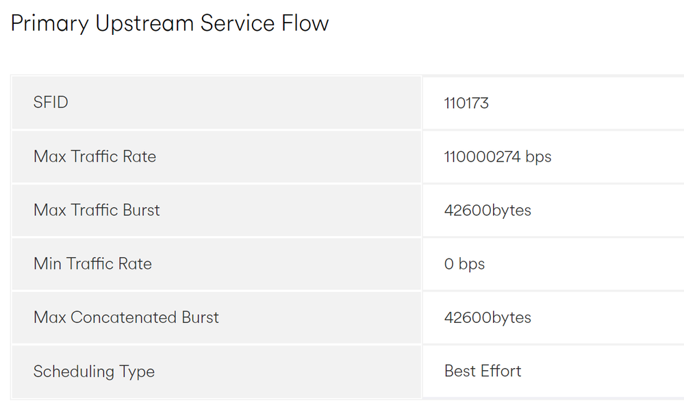

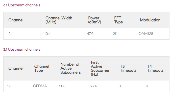

      Looking at your config stats you are indeed only provisioned for the lower 52 Mbps upload speeds, although not every area has had this upload speed applied yet. Mine has been applied and the max upload traffic rate is 110000274 bps, although https://samknows.com/realspeed/  shows my config as Package:Virgin Media,1000x50.

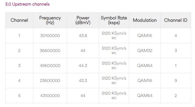

      I notice that you have a third party router, this may be affecting your upstream modulation, or it may be due to the wiring as they should all be 64 QAM, and you have two at 16QAM and one at 32 QAM.  This needs pointing out to the tech when they arrive as your speeds and/or connection isn't ideal.

  • They need to fix an upstream noise fault in your area going by those stats.

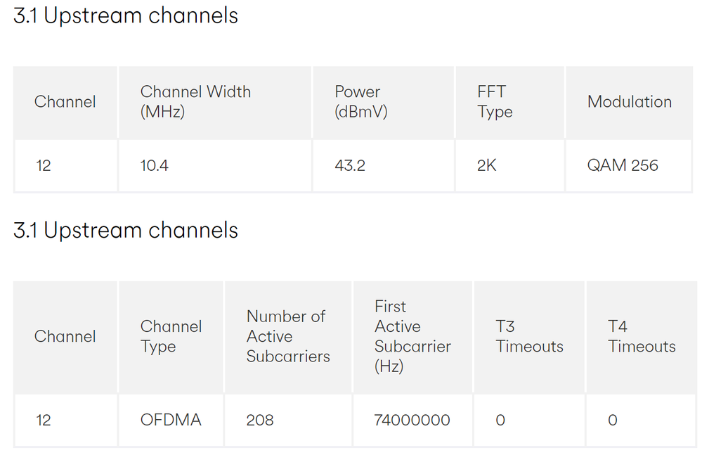

    From what we know about how it displays power, you need to add 6 dB to the 3.1 channel in order to compare it to the 3.0 channels. A 10 dB difference is borderline. The technician may be fixing that too.

    I had the engineer round this morning and he agreed with your points and his first proposal for a solution was to swap out my Hub4 to a Hub5, and install a 3dB attenuator to the coax line.
    After a quick provisioning of the new Hub5, my configuration profile is now as expected with the new 104mbps upload speed, and speed tests verify this is working as it should.
