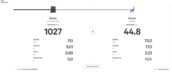

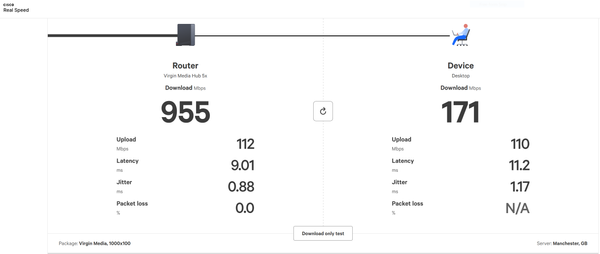

    Cisco results as below:

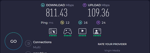

    Ookla result:
    I do not know anything about this, but was surprised to see that Ookla result came back with higher download speeds than the CIsco test. Ookla tests from device to server and those speeds are what I would expect from my 1gbps connection. However, Cisco device download test comes back with 170 mbps.

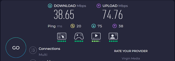

    If I use a WiFi connection, the results are worse:
    Ookla:

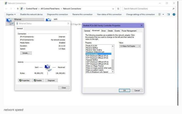

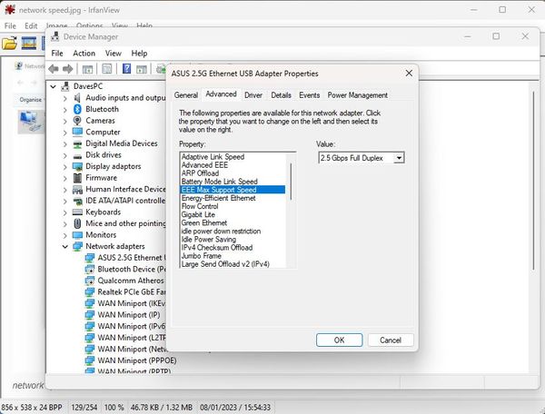

      What network card/adapter do you have in your desktop, and what speed is it negotiating at?
      You might also have to disable EEE settings for the network adapter.

    Please run the FULL tests on www.samknows.com/realspeed and post the results.  This should be done with a direct wired connection to the Hub.  Once done we can comment.   SamKnows firmware is indeed imbedded into the VM Hubs for this purpose, to show the speed to the Hub. After the Hub any speed issues are up to the user to investigate.
