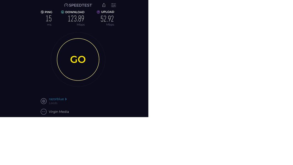

      Thanks for the reply
      This was the result from Ookla via browser and the one below by Ookla app
      Can't easily re create the original tests with samknows/realspeed because I've switched back to modem only mode on the Hub3 and it would involve another reset.
      When I tested it though the download speed on samknows/realspeed was well in excess of 500mb whilst Ookla was showing less than half of that. As I said earlier in test mode I only had 1 laptop connected with a Cat5e cable and nothing else wired or wireless

    Poor performance of the laptop or desktop computer ... or very often due to use of Wi-Fi
    I recently upgraded to an M500 package from M250 and using Ookla speed tests have seen no improvement.
    So when on M250 the download speed was around the 123Mb/s mark. A speed increase from VM to the Hub 3 would not be expected to produce any download improvement as prior to the upgrade some other (still present) issue is the limiting factor.
    That could be the laptop. .Complex security packages and any use of a VPN can drastically limit.
    If the laptop is booted into Safe Mode + Networking does its speed test result improve markedly ?
