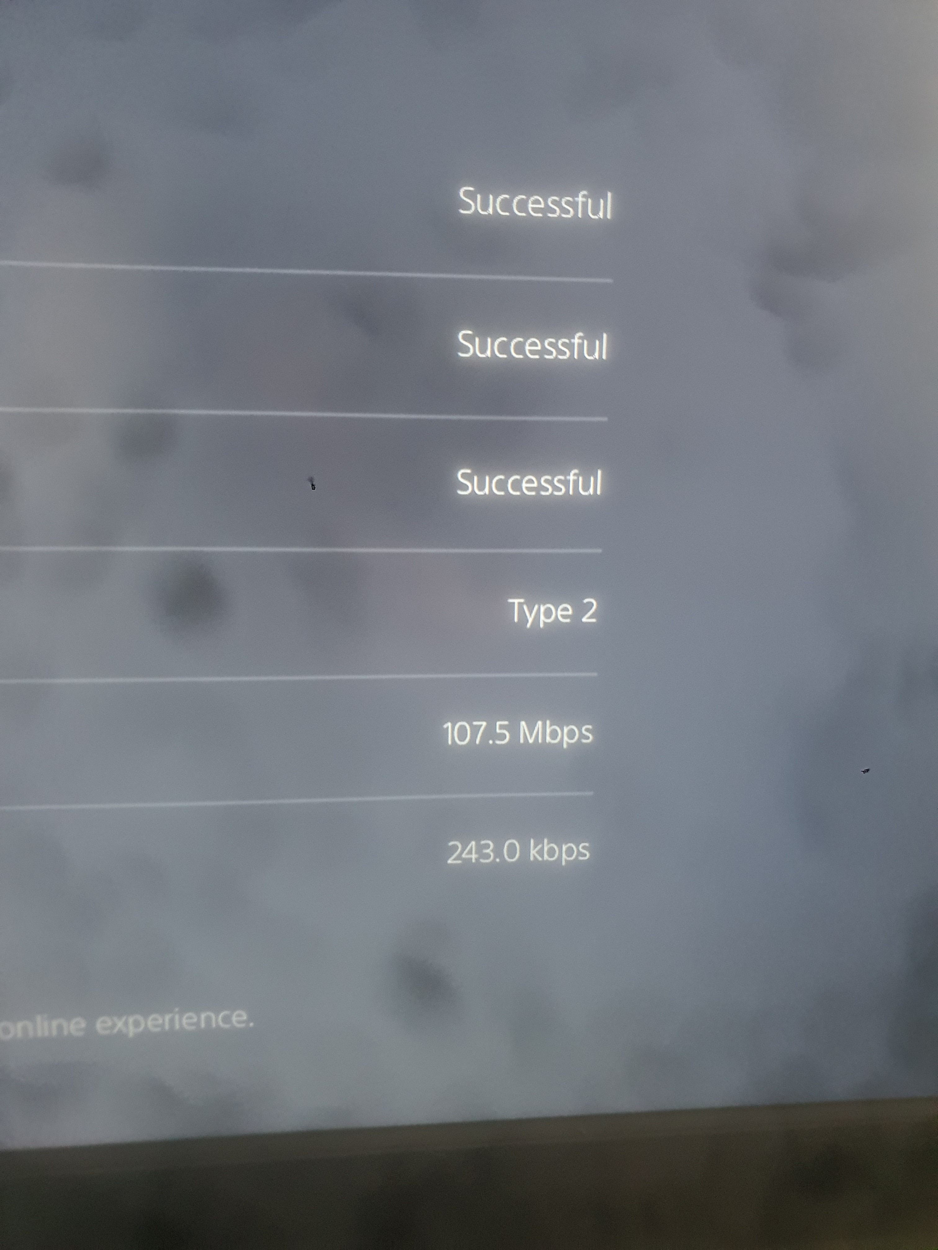

On 29th April I got home and was unable to stay online with my gaming PS5. Streaming etc all perfect no issues. I just can't do gaming.
I'm on the 100MB package.
I have no issue with the download, varies between 90 - 100mbps.
The issue is my upload it will not go above 1mbps. Prior to the 29th I would get an upload from 18- 21. So a considerable drop.
I have checked service status using the number and test online and via the app. I've done factory reset and rebooted. I've spoke to the fault team who advised intermittent issue I'm the area and it will resolve in time. Other than that they can't/refuse to help.
Is there a specific fault that would only throttle the upload?

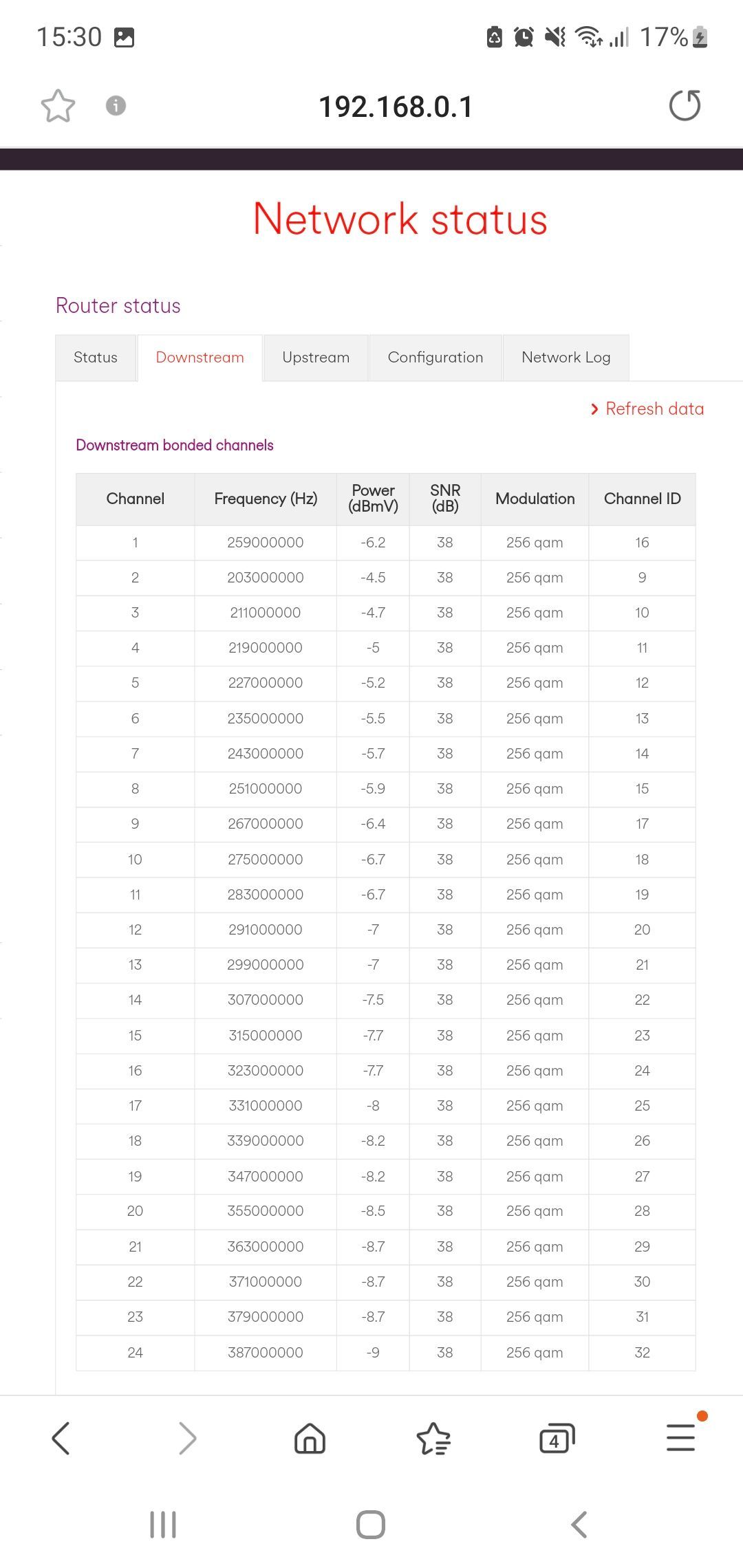

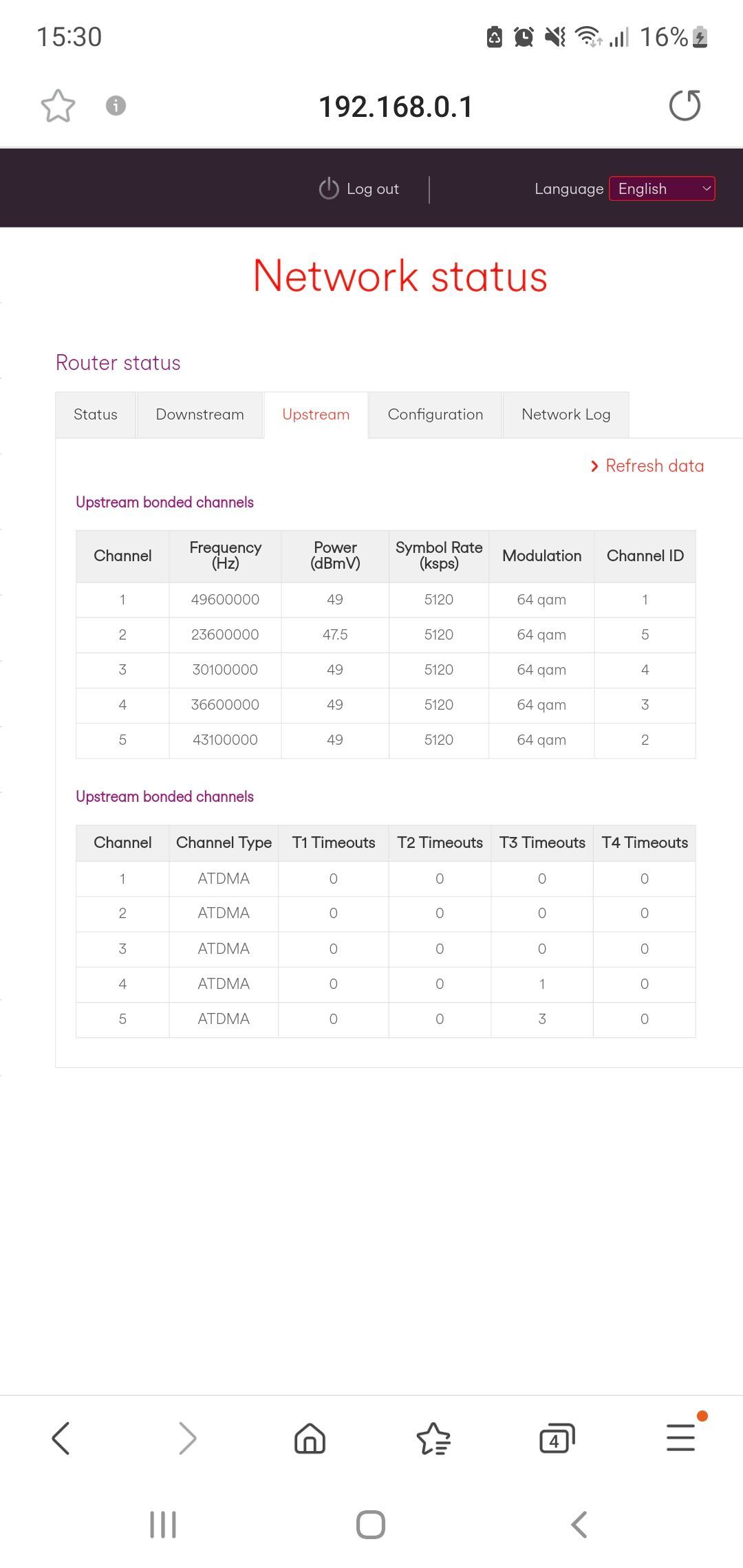

  • I don't know if these pictures help but it's took me 5 minutes just to upload them. Please help me, I'm getting no where on the phone lol.

  • It's upstream / return path noise by the looks. I see upstream channels with T3 timeouts, both channels adjacent to each other suggesting broadband ingress overlapping both frequencies.
