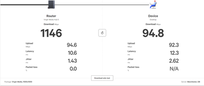

1gig but speed not going above 100mbps
hi there seems to be a problem with the speed for the last month or so it don't seem to go above 100mbps even though i have 1gig. i even reset the hub 5 to see if that would fix the problem but still didn't get anywhere near 1gig not even 200mbps on speed test was between 30 something and 100 something mbps.

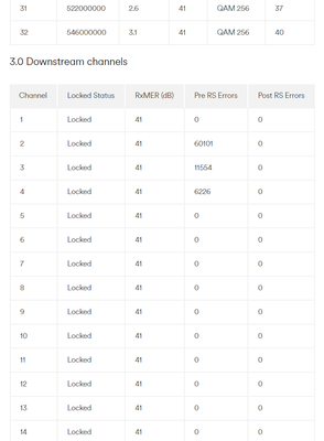

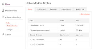

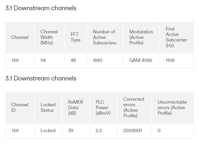

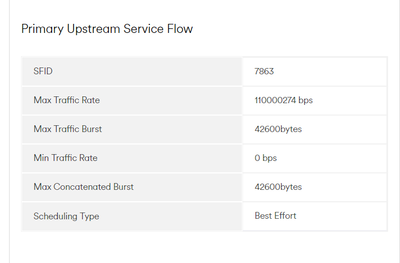

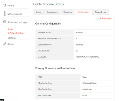

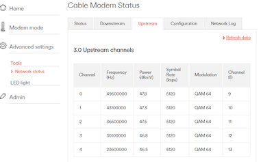

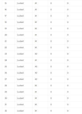

this is the information in the superhub if it helps

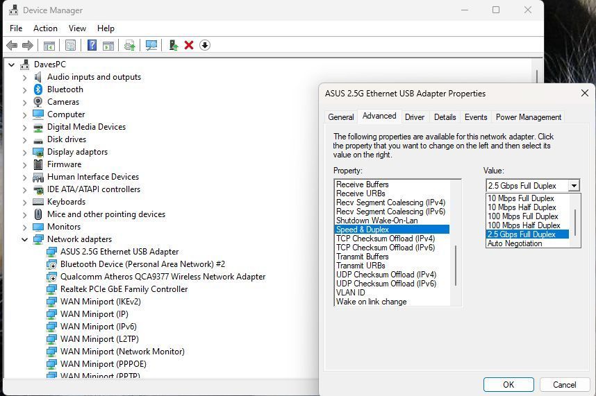

    If so check that the adapter settings are set to either 1.0 Gbps Full Duplex or  2.5G
    Press the Winows key and type in ethernet. Then select ethernet settings. Then change adapter settings. Double click Internet and it should show the speed as indicated on the picture below.
    If you need to change it change it, click Properties followed by Configure then scroll down as shown on the right and set the value to 1.0 Gbps Full Duplex.

    very strange connected to hub 5 wifi with phone and speed test was over 400mbps but on the router from modem mode it don't go anywhere over 100mbps same as the other computers in the house but then connected the xbox series x to the router and tried to download a game got over 700mbps was thinking maybe it's my tplink router but that don't make sense if xbox got 700mbps. might buy a new router and see but it won't make sense if xbox gets that but no other devices on the network are not.
