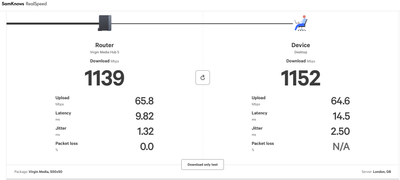

1gbit upload
I have been upgraded to 1 gig and while download speeds are as expected, upload is not, hitting 60mbps or so at best (it was hitting 50mbps on the M500 service)
