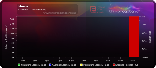

I have stared a BQM check and so far the graph is showing compete red.

    You need to post all the power levels as well including the PostRS errors.  As for the BQM you need to set your Hub to respond to pings from the Internet.

      I don't see a way on the Superhub 3 to allow it to respond  to pings.

      Good Morning ajo, hope you're keeping well and thanks for your post.
      Do you happen to have the aforementioned BQM graph available for us to view?
      Can you also confirm if indeed that this fault is still apparent?

        Hi David
        The BQM graph never worked. I cant see on the superhub 3 how to allow respond to pings.

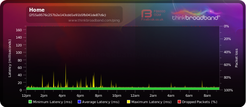

  • legacy1's avatar
    legacy1
    unplug power line adapters connect to hub without a VPN or proxy check your IP is a VM IP then re-setup BQM
  • ajo's avatar
    ajo
    How do I delete my previous post as it was not right.
