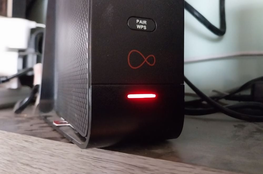

    Hi FatBadgerKilo
    When the Hub is in modem mode, the power light will be solid red.
    Are you able to confirm if you're seeing the same when the Hub's in router mode?

    I do have a permanent red light on the router even though I've rebooted which is another worry and I'm not sure how long it's been like that.
    In modem mode the LED is described as "magenta", but can look red to some.  A Hub 3 in Router mode should be white, but can age to yellowish.  If it is red in Router mode, it should be replaced, as that could be a faulty overheat warning.  The aging LED's on the older Hub 3's are a bit of a problem at the moment as the colours can't really be relied on.

      It's in Modem mode at the moment - not particularly warm to touch but the light is as red as a sunburnt Stoke City shirt.
