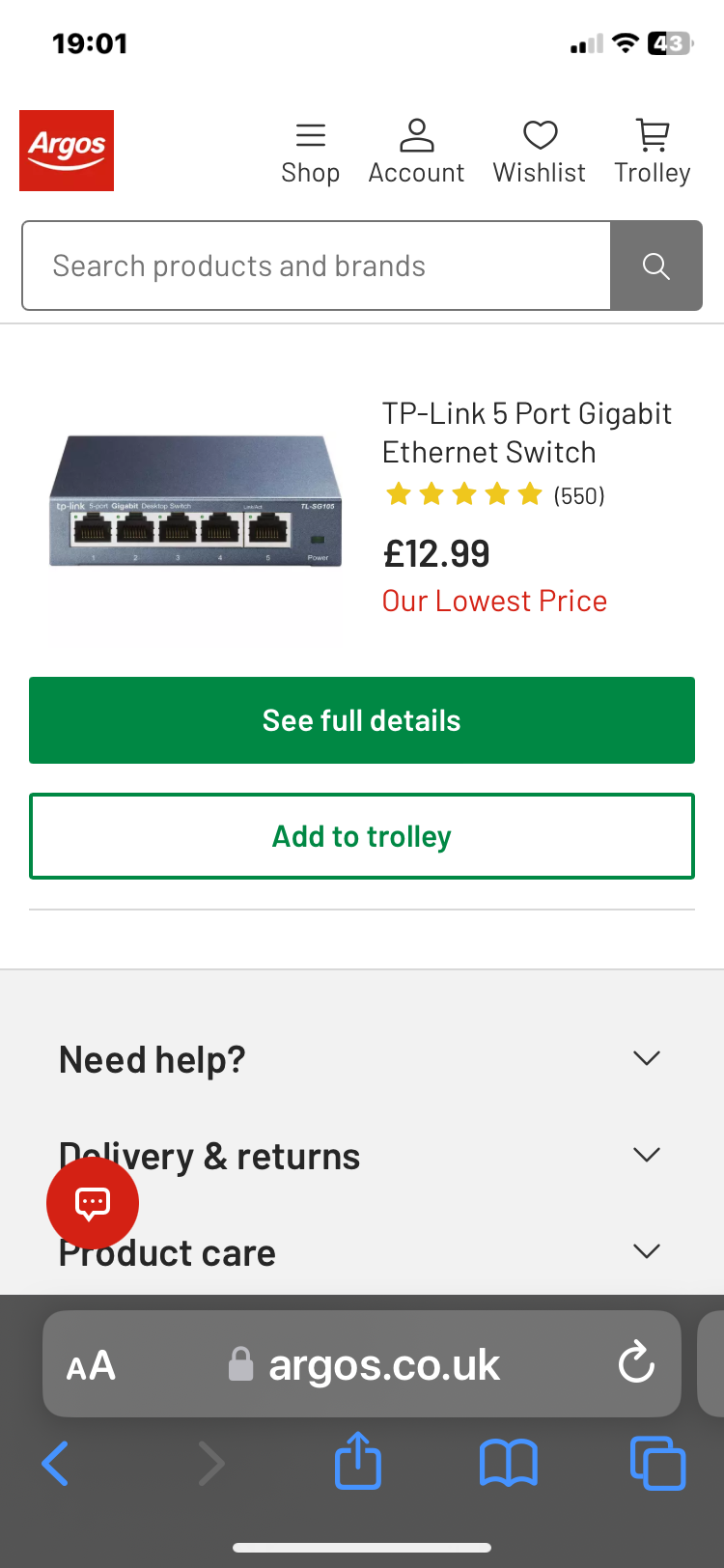

      Would this switch do the job ? So Ethernet from port 1 to the switch then all other equipment into the ports on the switch . Then hub into modem mode to disable the wifi from the hub . Then my wifi would be only from the deco mesh system
  • The whole point of modem mode is to turn the HUB into a 'dummy' device, to allow one wired device internet access.
    After that it's up to you how it's distributed on your third party hardware.
  • If the switch is plugged into one of the Deco nodes any switch will work, as long as the Deco is also plugged directly into the HUB.
