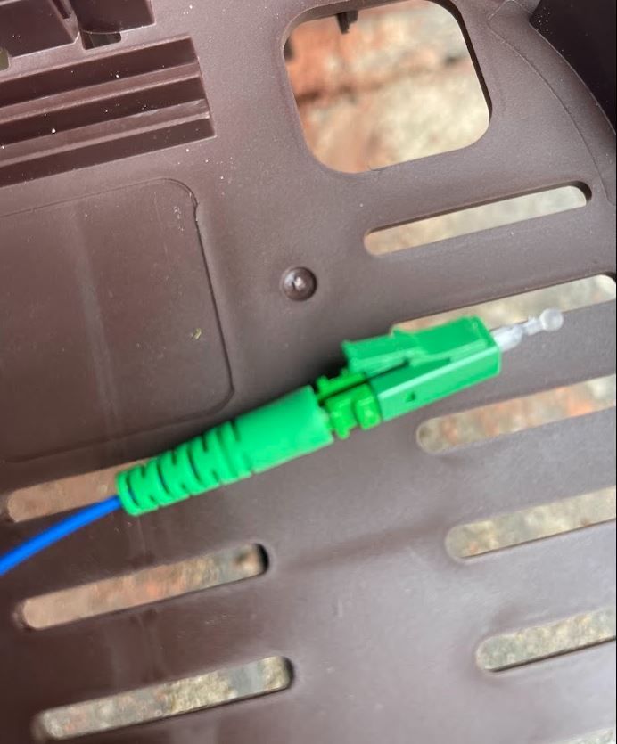

    And last question, do you know what type of cable is used in the Hub 5x: SC/APC or LC/APC?
    • lauragmail's avatar
      lauragmail
      This is the cable that today has been installed:
      Now waiting for the VM engineer and the router.
