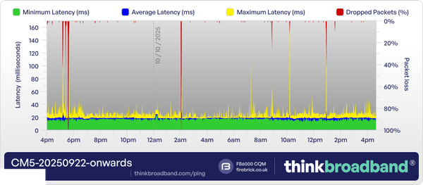

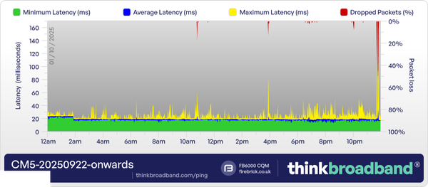

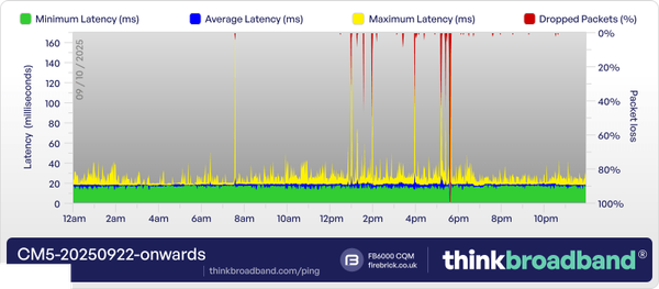

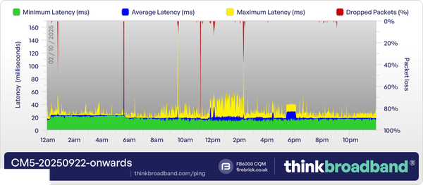

Hello,
I've been experiencing (usually very) brief connection loss intermittently for a couple of years now. After the 4th tech visit in 2023, and the subsequent CM self-installed replacement with a SuperHub 5 things were improved. My feeling was, and still is, that this later CM mostly masked/flattered the overall ongoing issue.
I'm reporting this now as I just won't get around to it otherwise and it'll continue to annoy me. It's been a case of it working well enough most of the time for me not to feel able to summon the mental strength to report it (LOL).
The timeline below is more cathartic for me than anything else. No, I didn't really want to be collating this stuff, but there we are.
Yesterday, whilst at home, I experienced about 7 drops, and added to the past week's drops, I'd had enough, so started pulling together what info I have.
Unprompted by me, I was then texted by VM yesterday to read my email re: "broadband connection may be being slow or sometimes disconnecting". I didn't receive one (and I have checked my spam folder, etc.) I assumed this was to suggest power cycling the CM, so did that. Unfortunately, no change following this.
The service status page at that point was coming back with "Intermittent signal in your area" (and it's the same today - now).
I appreciate this will probably yield a tech in the first instance, but for the record, I'm prepared to bet that the cabling from the pit/grid up and into the back of the CM is fine.
The reason I have the records below is my habit to quickly grab the CM logs/levels (using my phone) each time I experience a drop.
Please can you assist?
Jon.

11/08/2025 Brownout in the house late evening - nothing stopped completely, but lights did flicker
12/08/2025 Moved external(/CM?) IP address - middle of day 2.50pm-ish - no obvious spikes of dropped packets in BQM prior to this date
11-09-2025 15:56:18    critical    16 consecutive T3 timeouts while trying to range on upstream channel 1;CM-MAC=a4:22:49:ed:9b:b0;CMTS-MAC=00:9e:1e:58:2e:b4;CM-QOS=1.1;CM-VER=3.1;
VM status page saying something like "an intermittent signal issue today"
22/09/2025 Evidently motivated to re-visit ThinkBroadband BQM to see what was occurring (I didn't note any levels at this point). Noticed the CM IP change and thus set up a new BQM to monitor from this point.
23-09-2025 18:57:21    critical    Started Unicast Maintenance Ranging - No Response received - T3 time-out;CM-MAC=
23-09-2025 18:57:06    critical    16 consecutive T3 timeouts while trying to range on upstream channel 8;CM-MAC
23-09-2025 18:57:06    critical    Unicast Maintenance Ranging attempted - No response - Retries exhausted;CM-MAC=
23-09-2025 18:57:05    critical    Started Unicast Maintenance Ranging - No Response received - T3 time-out;CM-MAC=
23-09-2025 18:57:04    notice    CM-STATUS message sent. Event Type Code: 5; Chan ID: 1 2 3 4 5 6 7 8 9 10 11 12 13 14 15 16 17 18 19 20 21 22 23 24 25 26 27 28 29 30 31 32; DSID: N/A; MAC Addr: N/A; OFDM/OFDMA Profile ID: N/A.;CM-MQOS=
23-09-2025 18:57:01    critical    Started Unicast Maintenance Ranging - No Response received - T3 time-out;CM-0;CMTS-MAC=0    error    DBC-ACK not received;CM-MAC=a4
23-09-2025 18:56:46    critical    16 consecutive T3 timeouts while trying to range on upstream channel 1;CM-MA
23-09-2025 18:56:46    critical    Unicast Maintenance Ranging attempted - No response - Retries exhausted;CM-
24-09-2025 23:32:35    critical    Started Unicast Maintenance Ranging - No Response received - T3 time-out;CM-MAC=M-QOS=1.1;CM-VER=3.1;
24-09-2025 23:32:21    critical    Unicast Maintenance Ranging attempted - No response - Retries exhausted;CM-MAC
24-09-2025 23:32:21    critical    16 consecutive T3 timeouts while trying to range on upstream channel
24-09-2025 23:32:15    critical    Started Unicast Maintenance Ranging - No Response received - T3 time-out;CM-
25-09-2025 18:01:42    notice    CM-STATUS message sent. Event Type Code: 2; Chan ID: 25 27 28 32;
25-09-2025 18:01:34    critical    No Ranging Response received - T3 time-out;CM-
25-09-2025 18:01:33    warning    DBC-REQ Mismatch Between Calculated Value for P1.6hi Compared to CCAP Provided Value;CM
25-09-2025 18:01:32    critical    SYNC Timing Synchronization failure - Loss of Sync;CM-
29-09-2025 23:41:58    warning    DBC-REQ Mismatch Between Calculated Value for P1.6hi Compared QOS=1.1;CM-VER=3.1;
29-09-2025 23:41:47    critical    Started Unicast Maintenance Ranging - No Response received - T3
02-10-2025 14:18:10    critical    16 consecutive T3 timeouts while trying to range on upstream channel
02-10-2025 14:18:05    critical    Started Unicast Maintenance Ranging - No Response received - T3 time-
09-10-2025 16:23:26    critical    16 consecutive T3 timeouts while trying to range on upstream channel
10-10-2025 16:49:44    critical    16 consecutive T3 timeouts while trying to range on upstream channel
10-10-2025 16:50:28    critical    16 consecutive T3 timeouts while trying to range on upstream channel

    3.1 Downstream channels
    Channel    Channel Width (MHz)    FFT Type    Number of Active Subcarriers    Modulation (Active Profile)    First Active Subcarrier (Hz)
    159    94    4K    1840    QAM 4096    1108
    Channel ID    Locked Status    RxMER Data (dB)    PLC Power (dBmV)    Corrected errors (Active Profile)    Uncorrectable errors (Active Profile)
    159    Locked    0    5.8    3987689513    114419
    Log out Language
    Home
    Connected devices
    Modem mode
    Advanced settings
    Admin
    Router status
    StatusDownstreamUpstreamConfigurationNetwork Log
    Refresh data
    3.0 Upstream channels
    Channel    Frequency (Hz)    Power (dBmV)    Symbol Rate (ksps)    Modulation    Channel ID
    0    49600000    46.8    5120    QAM 32    1
    1    43100000    45.8    5120    QAM 32    2
    2    36600000    44.8    5120    QAM 32    3
    3    30100000    43.8    5120    QAM 32    4
    4    23600000    42.5    5120    QAM 32    5
    Channel    Channel Type    T1 Timeouts    T2 Timeouts    T3 Timeouts    T4 Timeouts
    0    ATDMA    0    0    226    0
    1    ATDMA    0    0    229    0
    2    ATDMA    0    0    238    0
    3    ATDMA    0    0    242    0
    4    ATDMA    0    0    234    0
    3.1 Upstream channels
    Channel    Channel Width (MHz)    Power (dBmV)    FFT Type    Modulation
    6    10    40.5    2K    QAM 256
    Channel    Channel Type    Number of Active Subcarriers    First Active Subcarrier (Hz)    T3 Timeouts    T4 Timeouts
    6    OFDMA    200    74000000    239    0
