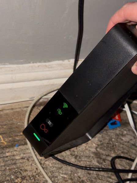

  • I’m still having issues with this,  every so often the modem will completely crash and be offline for hour, it seems to happen when I’m messing with my Ubuntu server, it seems to crash the router. I literally think my router is faulty, when/if it comes back on I will have a new local ip so I will need to update my websites cloudflare etc to match the new local ip, it is so annoying and is like torture having to keep updating the router and going back to factory settings losing all my port forwarding etc.
    On the picture the bottom green light flashes green and then it will go a solid green colour and then the middle green light will flash and it will do this for hours, it’s been having intermittently for months, everything works fine 99% of the time it just when it does this crashing

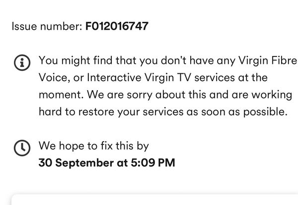

      Checking our systems, I can see that there is a fault open that is affecting you. The details of that are here:
      • ➡ Fault reference number: F011780659
      • ➡ Estimated fix time: 23 Apr 2025 09:00
      • ➡ Description: You might find that your Virgin Fibre, Voice and Virgin TV services are intermittent, with the picture freezing or disappearing now and then. We are sorry and our engineers are working hard to resolve this for you.
      There is a note of this on your account so the relevant teams are aware you are affected and this will ensure the account is assessed automatically for automatic compensation once the fault is closed as resolved. You can view more information on this, as well as the eligibility criteria here 👉 Automatic Compensation
