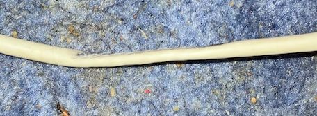

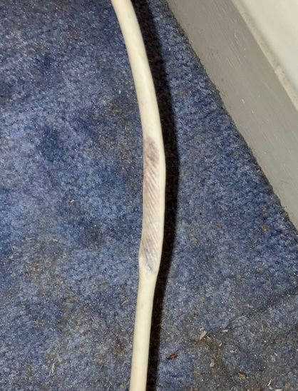

Damaged coaxial cable
Today I discovered that my bed has been sitting on the coax cable coming into the bedroom for years, flattening it. The Internet and TV still work, but I’m concerned the damage might have been contributing to our speed being not quite as high as it should be, and/or the cable may suddenly fail cutting off our service. I suspect we may need an engineer to cut out the damage and put a new shunt on the end.
We have already scheduled an engineer visit for 3rd October to investigate this, but I was advised on the phone that there would be a £25 charge for this. I don’t think it requires a full re-pull though; what is the charge actually for?

  • The inner core is probably intact (hence no service otherwise), the outer braiding is flattened but it should not be making any difference to your speed, it' still shielding.
    Without you posting your hub log on downstream and upstream SNR and power levels, it's hard to debug further. Also unclear if you meant WiFi for connections or wired.
    The £25 charge is for engineer call out and any work done. He may fit new cable, check your SNR and power levels on a meter, check the outside wall box for good non corroded connections and depending on the engineer, he might even facilitate a hub swap if yours is an old model. No guarantee on that, but if they believe the more sensitive tuner (yes it IS a tuner) in a HUB5 may help, they have grounds.
