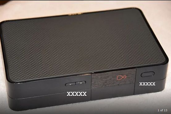

    You need to turn off the 360 by the switch on the back of the box;  then on the front of the 360 box  hold down both the standby/power button and the - (minus) button at the same time, as per screenshot below. Then turn on the 360 again whilst keeping hold of those buttons for a further 30 seconds.

      Thank you newapollo.  Looking at your screenshot it's a V6 box that is causing problems.  I did try the +/- trick, but am going to try again using your instructions.
      OK, I tried and got a solid black arrow over a white horizontal rectangular box.  The arrow seemed to be 'filling' and turning white, which was hopeful, and the power button on the v6 box went white.  Then it went orange again, the welcome screen came on and now is just repeating  that cycle over and over. 🙄
