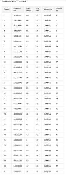

Hello all, My setup: Hub5 in modem mode connected to UXG-Max (Ubiquiti) Hub5 details: Standard specification compliant : DOCSIS 3.1 Hardware version : 1.2 Software version : LG-RDK_7.6.20-2306.5 Cable MAC address : () Cable modem serial number : () System up time : 1day(s)3h:48m:4s Network access : Allowed All worked fine for almost 1.5 years, but recently, something must have changed. On UXG, I get the following Internet disconnect errors: Your primary internet Virgin Media was disconnected and has been restored.Today at 12:47 Your primary internet Virgin Media was disconnected and has been restored. Feb 20, 2025, 20:36 Hub5 logs: 23-02-2025 12:47:56 critical 16 consecutive T3 timeouts while trying to range on upstream channel 8;CM- "----" 20-02-2025 20:36:59 critical 16 consecutive T3 timeouts while trying to range on upstream channel 8;CM- "---- Any ideas guys? Thanks, myky Power Levels:
