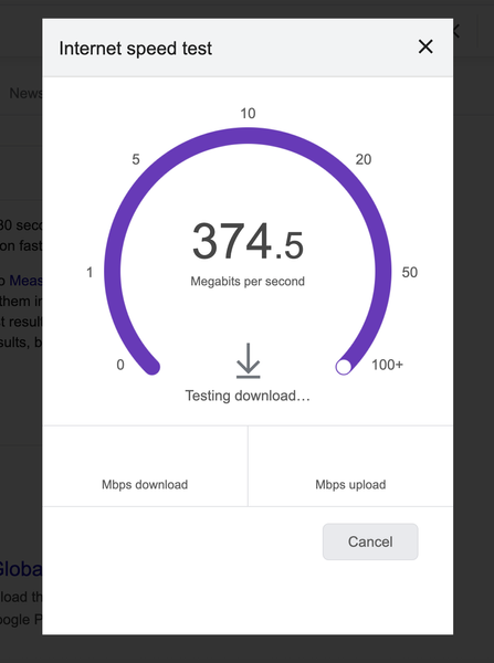

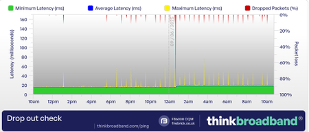

Hi, I have been a VM broadband customer for many years. I am on the M350 broadband package. Over the past week I have had frequent internet dropouts spanning multiple days. Annoyingly this is happening intermittently which makes it harder to debug. There are no known broadband issues in my area. My internet can be working fine for a good few hours but suddenly I will have no internet bandwidth on my devices and I am unable to access any web pages. When this happens the connection drops for varying periods of time ranging from a few mins to sometimes as long as an hour. When I have no internet connection there doesn't appear to be any change in the status lights on the superhub. I have the superhub 5 which I upgraded to over 4 months ago and it's been working absolutely fine until last week. The superhub is running in router mode. I connect from multiple devices over wifi and there is no difference which device im using, the problem occurs on all of them. I have tried restarting the superhub many many times. Sometimes the internet comes back when the hub reboots but often it doesn't. When the internet is working I get very fast speeds: I setup a Think Broadband broadband quality monitor a few days ago. Below you can see some graphs over the past few days... Friday had no dropped packets: Saturday had some: This morning / overnight has been terrible: I would appreciate some help to try and understand what's going on here as it's been extremely disruptive especially when im working from home. Thanks in advance617Views2likes9CommentsHub 5 dropout

I've been having issues where my connection experiences spikes and complete dropouts, 30 minutes apart. I have been running BQM since Friday 6/6/25, as you can see in the attached graph from 8th-9th, the space between drop outs are quite consistent. I have: - Fully reset to factory settings. - Disabled IP Flood Detection (suggested solution on another site) - Tested other devices (another PC, 4 Phones, Xbox Series X, 2 TVs) all experience the same connection issues. - Pinged various IP Addresses and all came back with no loss. I am connected via Ethernet to the 10gbps port, my PCs ethernet port is compatible with those speeds: https://www.speedtest.net/my-result/d/812c9d78-d2e7-4766-9f17-9cd7acd688b1 Other devices are Wifi (PC is Wifi 6, rest are 5ghz/2.4ghz) Package Info: 2gig up and down These are my router stats: PON modem status Online Connection mode IPOE IPv4 firewall Online IPv6 firewall Online IP_VOIP Down IP_DATA Up Transceiver temperature 29 Transceiver voltage 3 Laser bias current 12 ONT transmit power 5200 ONT receive power -16400 Network access Allowed Baseline Privacy disabled PON Mode XGS-PON 09-06-2025 11:12:46 notice GUI Login Status - Login Success from LAN interface 09-06-2025 11:11:29 notice erouter0 ipv6 address is empty 09-06-2025 10:56:29 notice erouter0 ipv6 address is empty 09-06-2025 10:41:29 notice erouter0 ipv6 address is empty 09-06-2025 10:31:20 notice GUI Login Status - Login Success from LAN interface 09-06-2025 10:31:14 notice GUI Login Status - Login Success from LAN interface 09-06-2025 10:30:37 notice GUI Login Status - Login Success from LAN interface 09-06-2025 10:30:06 notice GUI Login Status - Login Fail from LAN interface 09-06-2025 10:26:29 notice erouter0 ipv6 address is empty 09-06-2025 10:11:29 notice erouter0 ipv6 address is empty 09-06-2025 09:56:29 notice erouter0 ipv6 address is empty 09-06-2025 09:41:29 notice erouter0 ipv6 address is empty 09-06-2025 09:36:50 notice IPoE IPv4 ping failed 09-06-2025 09:26:29 notice erouter0 ipv6 address is empty 09-06-2025 09:11:29 notice erouter0 ipv6 address is empty 09-06-2025 08:56:29 notice erouter0 ipv6 address is empty 09-06-2025 08:41:29 notice erouter0 ipv6 address is empty 09-06-2025 08:37:10 notice IPoE IPv4 ping failed 09-06-2025 08:37:00 notice IPoE IPv4 ping failed 09-06-2025 08:26:29 notice erouter0 ipv6 address is empty 09-06-2025 08:11:29 notice erouter0 ipv6 address is empty 09-06-2025 07:56:29 notice erouter0 ipv6 address is empty 09-06-2025 07:41:29 notice erouter0 ipv6 address is empty 09-06-2025 07:36:49 notice IPoE IPv4 ping failed 09-06-2025 07:36:39 notice IPoE IPv4 ping failed 09-06-2025 07:26:29 notice erouter0 ipv6 address is empty 09-06-2025 07:11:29 notice erouter0 ipv6 address is empty 09-06-2025 06:56:29 notice erouter0 ipv6 address is empty 09-06-2025 06:41:29 notice erouter0 ipv6 address is empty 09-06-2025 06:36:59 notice IPoE IPv4 ping failed The network logs go much further, with regular error messages stating "IPoE IPv4 ping failed". This will be the 2nd router I am on, having the 1st replaced by an engineer for similar issues. Frankly, at £96 per month, I expect a far superior service. The speeds are good, sure, fantastic even. But it's no good having "lightning speeds" when you can't use them! If anyone else is experiencing this issue, or similar, please feel free to contribute your findings. VM, I eagerly await your advice/solutions as this is now affecting my employment. Regards.674Views0likes6CommentsFrequent and disruptive internet drop-outs
