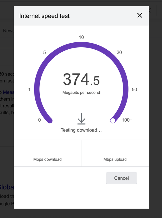

When the internet is working I get very fast speeds:

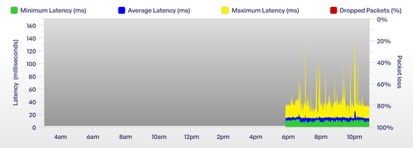

I setup a Think Broadband broadband quality monitor a few days ago. Below you can see some graphs over the past few days...

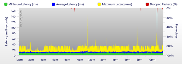

Friday had no dropped packets:
Saturday had some:

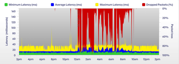

This morning / overnight has been terrible:
I would appreciate some help to try and understand what's going on here as it's been extremely disruptive especially when im working from home.

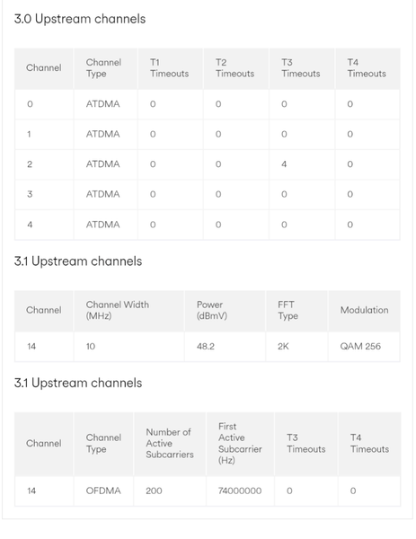

    If you have not rebooted the hub and try not too if you can look in the hub loggin for T# times outs if any have happened in upstream.
    • gervinho's avatar
      gervinho
      I don't think I've restarted the router since Friday. Are these the timeouts you were referring to?
      • legacy1's avatar
        legacy1
        Odd how there are not more timeouts...

    I also took some snapshots from my router logs when the internet times out:
    Any suggestions would be appreciated!
