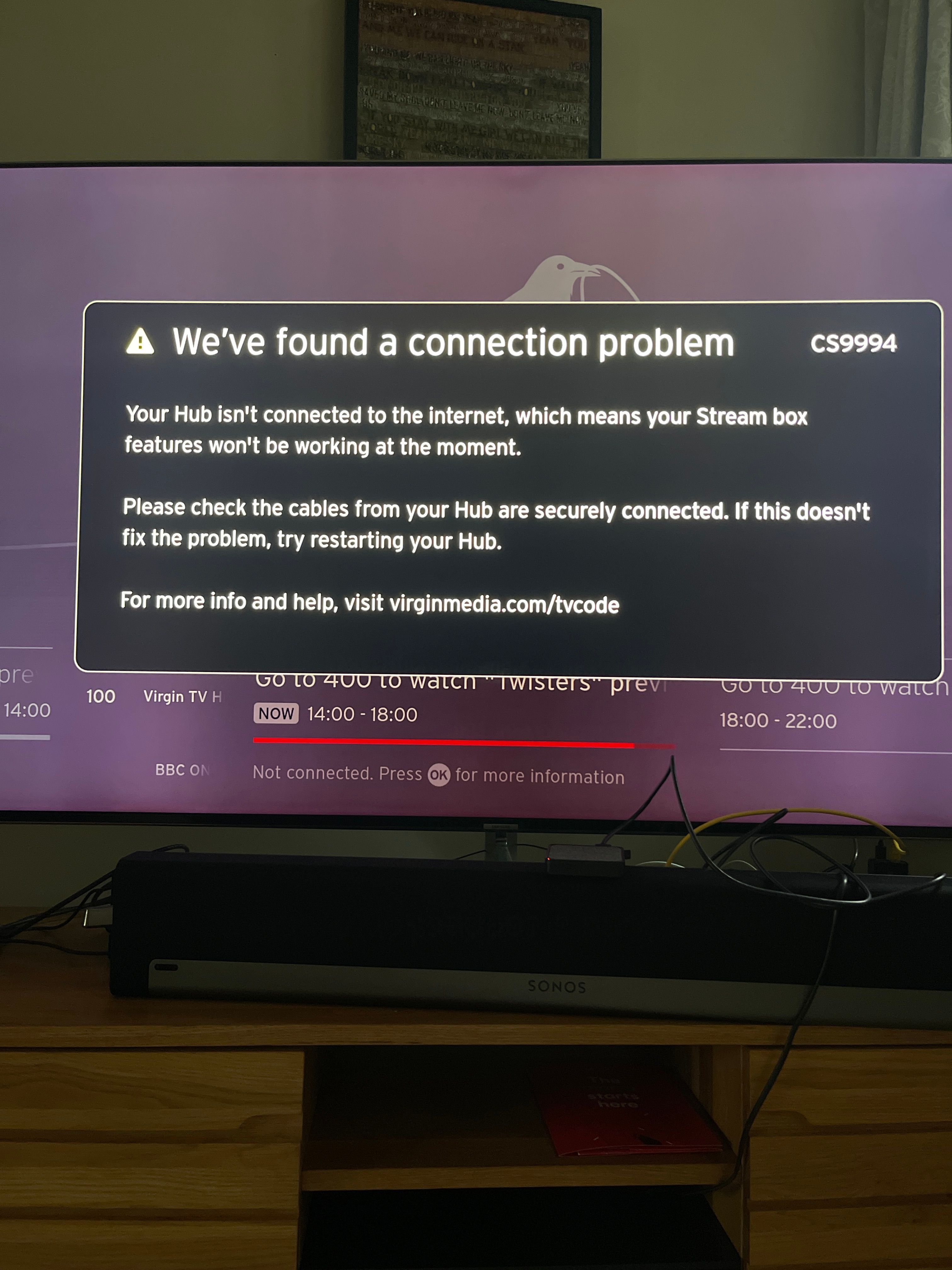

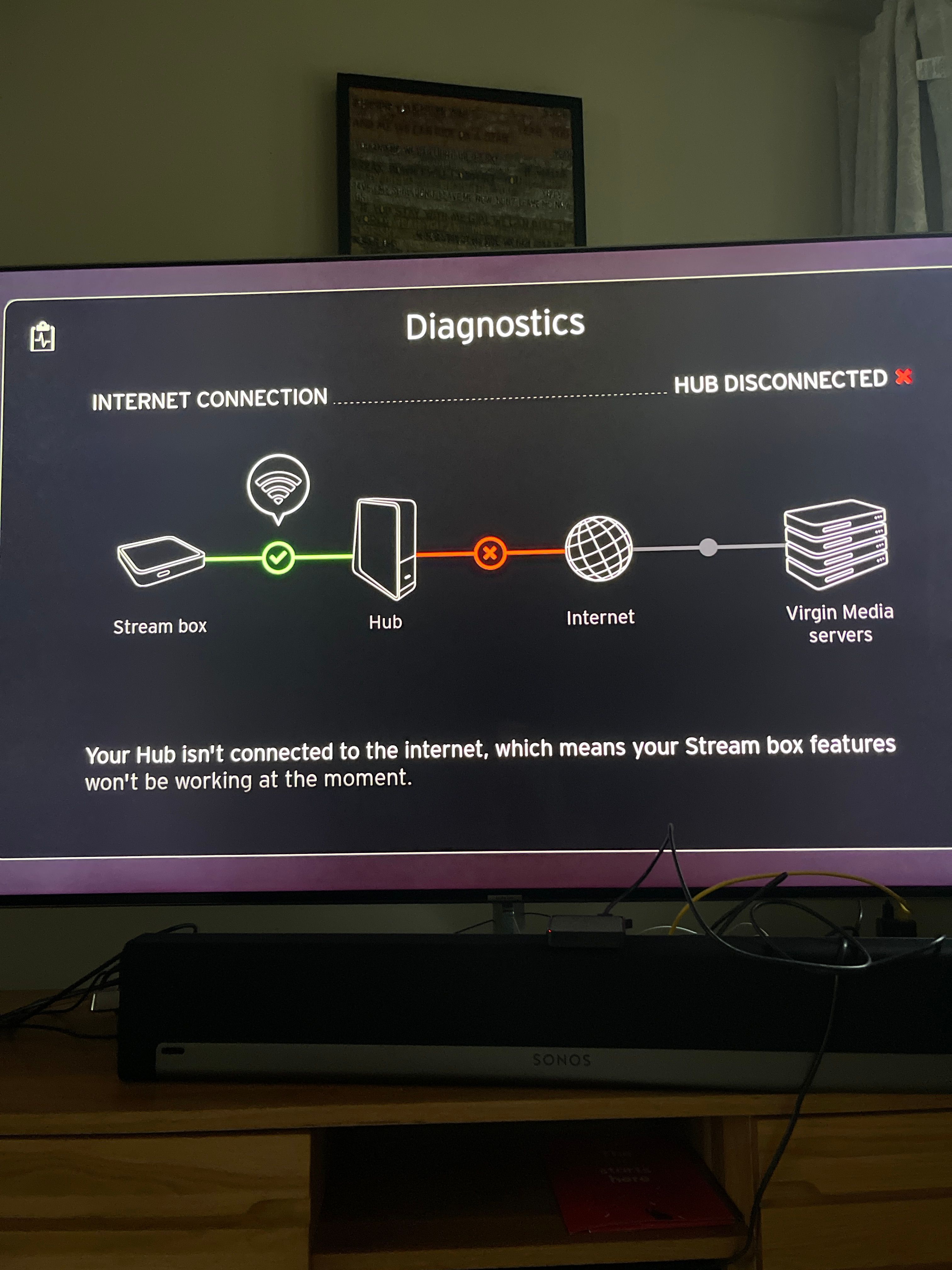

Received new stream box today as the one I’ve had for 2 months has never connected for more than a few hours and was faulty. Having spent an hour today in the phone getting the new stream box set up (rebooting the WiFi etc) as it wouldn’t find the stream, the same issue is happening. Either the tv doesn’t find the source or when I get onto virgin I either get not connected to the WiFi or no channels. The internet is connected. I have the Ethernet cable in too and have tried both connections. To get it to work again if the tv gets turned off means Resetting the modem, reconnecting the box and generally taking ages. Anyone else had issues like this as it’s beyond ridiculous. (We’ve had virgin for years but the stream box was to replace the older larger tv box (which always worked fine!)

    Those screens suggest a problem with the Hubs internet rather than the Stream box.  Post the Network log and power levels of the Hub for comments.
