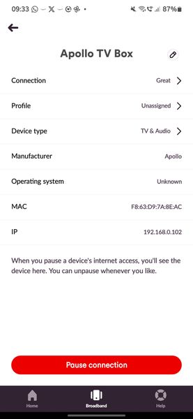

      So the error has occurred again this morning, first CS2017 came up then, a few seconds later, CS9994.
      I've checked the Connect app and the box is shown connected to the Hub 3, the same as yesterday, so it doesn't appear to be trying to change connection to the wifi pod. The Connect app also says that the Stream box's connection to the Hub 3 is 'Great'.
      In the Stream box diagnostics menu, it shows the box is connected to the Hub 3, but not connected to the internet. All other devices connected to the Hub are working and connecting to the internet fine.

      The error has happened again this morning, first CS2017 was displayed then, after a few seconds, CS9994.
      I have checked the Connect app and the Stream box is connected to the Hub 3, the same as yesterday, and the connection is marked as 'Great' so it doesn't appear to be trying to switch between the Hub 3 and wifi pod.
      On checking the Stream box's diagnostics menu, it says the box is connected to the Hub, but not the internet - it says 'Hub disconnected' with a red X next to it at the top. All other devices connected to the Hub continue to be able to access the internet as normal.
