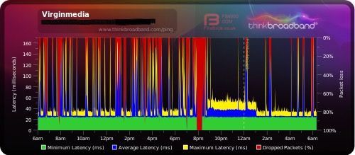

Lag spikes throughout the day
https://www.thinkbroadband.com/broadband/monitoring/quality/share/9bb10fc1c84e71c73274365b91ea136a1819d886
I was noticing lag spikes while gaming so setup a BQM, could anyone with more knowledge  take a look please.
I have not set one up for a couple of years, but cant remember the graph being this choppy.
It is not showing now, but i did notice earlier that a couple of the "Upstream Bonded Channels Modulation" were "32 qam" and not "64 qam".
Thanks for any help offered.

    Try checking with Area faults on 0800 561 0061 or if you have a VM landline 150 as small local faults are not listed on the VM status page.
    Also, terrible BQM.  Something is amiss.  Your stats all look fine at the moment, but post your network log as well for comment.  Check the connections are at least "finger tight" as loose connections can cause noise ingress.

        Lee_R wrote:
        We've had a look at our systems and cannot find any issues from our side.
        BQM don't lie🙄
        and what the hell has smart WiFi got to do with BQM showing a problem!
    Nothing much in the logs apart from SYNC errors on the 26th, along with the Time being reset to 1970. That's a normal thing btw, the Hub always resets to 1970 when it looses time from the network NTP servers.

  •  this is todays BWM, this is not caused by Wifi being switched off on the SuperHub 3 !!
  • so last night the TV also started playing up, could not watch anything as the picture kept freezing.
    So at 8pm i did another pin hole reset, So as from 8pm last night nothing is connected to the Superhub at all, nothing connected by LAN and nothing connected by Wifi to the hub, not even my phone line is connected,
    The Superhub is in Factory Settings, Wifi is on, i have not changed anything and as you can see by the BQM this has not made any difference.
