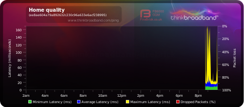

For the last 4-5 months I've been getting really frustrating lag on games, the ping within the game will spike occasionally to 180-200ms and will obvious cause jumping etc..
I phoned VM and they advised that my Omada gear was likely the issue, so I reluctantly dropped the VM Super Hub out of modem mode and into router mode - no dice.
I'm honestly at my wits end with this, the service is completely unusable, I never get > 800mbps on my line even though I'm paying for 1gbit.
Stats:
[url=https://www.thinkbroadband.com/broadband/monitoring/quality/share/da89f701edd0196d557ce6e68b2b3f101ff51633][img]https://www.thinkbroadband.com/broadband/monitoring/quality/share/thumb/da89f701edd0196d557ce6e68b2b3f101ff51633.png[/img][/url]

  • 17-09-2024: Yet again incredibly poor performance on the connection, major packet loss to the point of service outage last night (16-09-2024).
    Complaint that is logged with Virgin Media has essentially came back with steps like "Try repositioning your router, try turning it on and off". How insulting.
    I've got to the point of ruling out all of my physical network by directly connecting a single computer with a cat6 cable to the superhub and I still get issues.
    Tired of paying for a service that has me switching to 4g to have teams calls in the daytime, let alone gaming performance in the evenings.

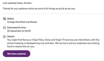

  • Yet another issue in my area! Amazing, but you're right, it's probably my gear that's the issue.
    Casual 1 week fix window for that too. Joke.
  • Specialist technician has come and gone. Issues are still present:
    Joke of a product you are selling.
