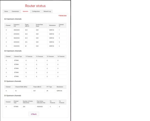

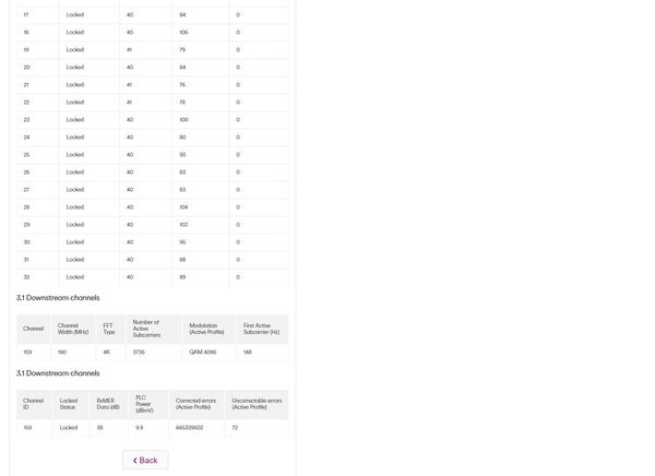

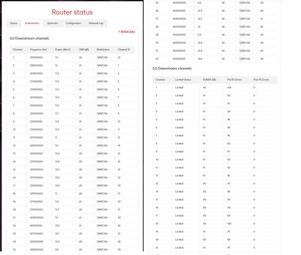

My VMHUB5 has lots of T3 timeouts and lots of post/pre RS errors when in router mode, when in modem mode using my NETDUMA R3 it is just Pre RS errors that are on the logs. My power levels was near the limits even with an attenuator but definitely seems better without the attenuator so that has been taken off and power levels just over limit on upstream and downstream.

    Your downstream signal levels are out of spec, but that won't be affecting the routing.
