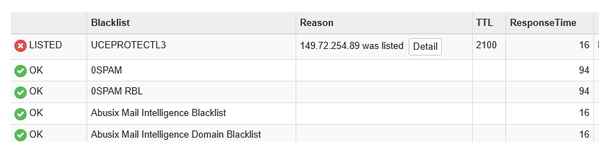

      The relevant IP address is that of WD - 149.72.254.89. It's *only* blacklisted on UCEPROTECTL3, which youve confirmed isn't being checked by the VM mail processing.

      Do you hold emails based on the UCEPROTECT level?

        Weโ€™re really sorry for any issues youโ€™ve experienced, and thanks for getting in touch with your query Bmo. We can confirm that we do not use UCEPROTECT levels to hold or filter emails.
        If youโ€™d like to check whether your IP address may be listed on any blacklist, you can find more information here:
        ๐Ÿ”— https://www.virginmedia.com/help/security/is-my-ip-address-blacklisted
