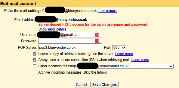

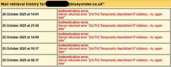

Sigh. Cannot connect via Gmail "blacklisted IP Address"
Tonight, emails to my Blueyonder address stopped coming through my Gmail app.
To connect I use VM's POP3 settings which they seem happy to keep messing about with. Now I am getting: "Authentication error. Server returned error "[AUTH] Temporarily blacklisted IP Address - try again later"
I've tried with/without VPN. I've tried through mobile hotspot. I've tried getting a new password via Manage email app password process. I've tried both my B/Y and Gmail email addresses.
Any ideas?
  • FIXED!!!!!
    Don't use the O2 ID you used previously without issue, use 'email app password' instead! This policy has clearly changed. TL;DR at bottom

    I tried the Home / Account settings / Identity and Security settings / 'Security settings' tab then select 'Account recovery code' . This generates a string of words. I tried that in Gmail with both my BY and Gmail username. Nope.
    TL;DR
    I then went Home / Account settings / Identity and Security settings / 'ID settings' tab' / Manage your products / Manage email app password / Get new password.
    This generates a string of words too. But the important bit: note which address appears under 'Email address' near the top - this may NOT be the same email address as your new O2 ID email username!! This happened to be my BY email address. I tried this in Gmail and voila!
