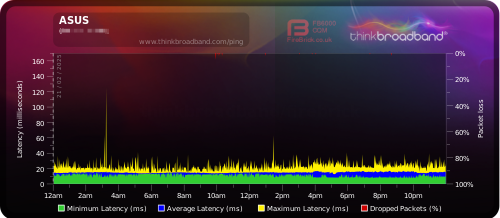

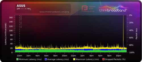

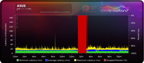

Hello my upstream has 18 t3 timeouts on the 3.1 channel also uncorrected errors on the downstream 2 and a half billion errors on this profile, I only full reset last week or so. I was getting a gig down load speed and upstream 110, downstream bursts to 700 quickly drops to 5/600mbps, now you have dropped upstream to 10.4 mhz and Subcarriers to 208 my upstream is 57 last check 40 odd sometimes on the best WiFi router on earth asus gt-axe16000 so not my equipment before you say it.

  • Why is my hub stats reset yesterday? I did not do that, anyway 20th 2pm terrible packet loss profile added, hub stats show constant profile changes why please? Never used to get pre rs errors now profile has 2.6 billion in 48hrs.
