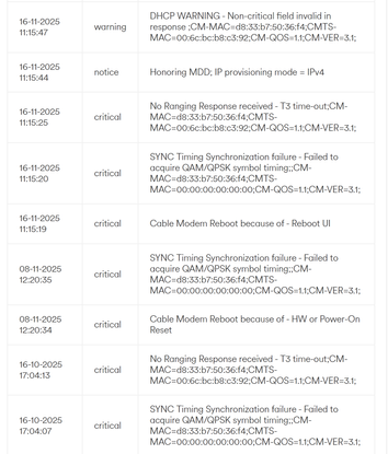

The last time this happened was 16th November at around 12:51am. Could you check the logs to see what happened please?

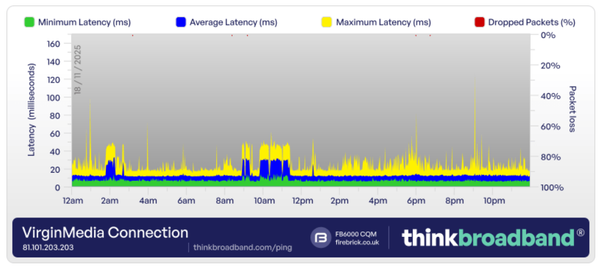

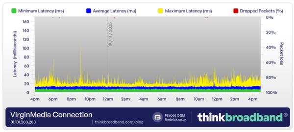

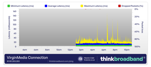

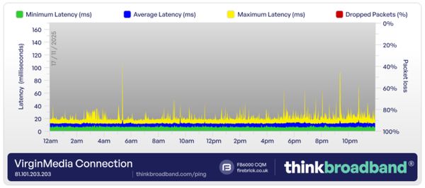

      Thanks - I've set up a BQM now, and will keep this thread updated with the results!
    Please post the power levels and logs for comment. What are the lights doing on the Hub when this event occurs?  Setup a BQM as suggested by legacy1​   for monitoring and recording your incoming circuit.

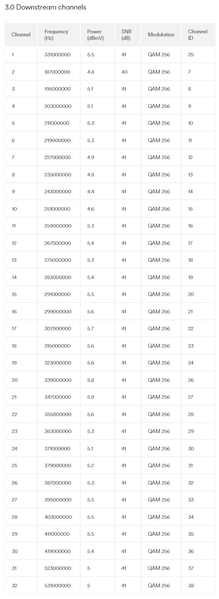

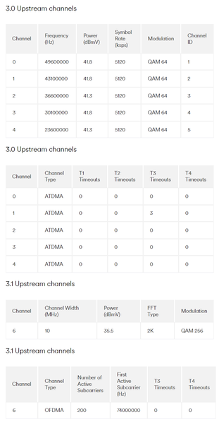

      Logs for around the time the blackout seemed to have occured:

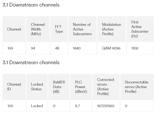

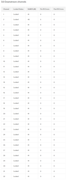

      Downstream power levels, as of now:
      Upstream power levels, as of now:
        Can't see anything amiss with those power levels etc.  Maybe the BQM will show something once it's populated for 24 Hrs.
    Is this Hub 5 on software: LG-RDK_11.6.2-2410.1  i.e. the version known to have Wi-Fi blackouts

      Oh, I just checked - software running on Hub 5 is LG-RDK_11.6.2-2410.1
