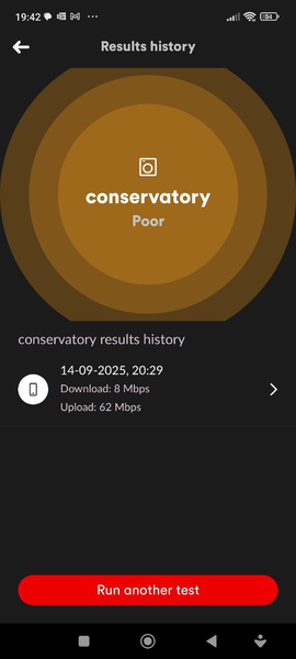

      What WiFi speeds are you getting in the conservatory please?
      Please post us a picture of the speed test result and we can advise further.
  • There are places in the conservatory that the signal is not strong enought to connect at all.  The above image is what I got when I did manage to connect.
