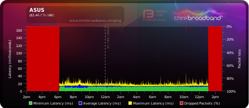

What is happening in south bristol? Can we get some help?
Just a brief message to ask what's happening in South bristol, I been trying to get my parents connection fixed for a long time there tv and streaming services are really effected. Mine up until recently was in a reasonable state. So I've been getting up and down profile changes every day is this normal? What isn't normal is the 15, 20 in one day after many 60 second resets it always goes back to bad within minutes or hours.
Bqm shows constant packet loss, correctables shows 6 digits after reboot, but populates very quickly to the billions on my down profile. Parents 3.1 ds is over 10dbmv to high and gets double sometimes triple digit uncorrected on the 3.1 ds, numerous profile changes per day also. There bqm is terrible and has been for months. I checked for area for any work or faults on the phone says there is none. WiFi for them don't work hub will not let me change channel or frequency for the 2.4ghz, it shows try again, also won't apply the disable smart WiFi.
Looked outside to check there f connectors for loose ones could not believe the state in there, disconnected line and fp attenuator just left there all tangled and not in good order. Let's be real the problems are network side.

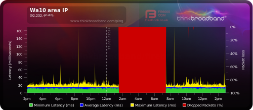

Some help would be appreciated, I've just setup 2 more bqm today at different local homes to show its not my internal line as senior engineer already confirmed good to the taps, yet sometimes vm ask about my asus gt-axe16000 which is nothing to do with anything or the qos I recieve. I will add some bqm and stats if anyone can see anything I can't as I'm a mere customer here. This is getting out of hand. Many thanks good day. 👍

    So they still have a connection during these BQM outages.
    What service do they get, what goes wrong that they complain about?
    There may be another reason for the BQM indications. It has failed before.

      Hi jpeg1 thanks for your reply, yes the connection is running at these red periods, there complaint is same as my parents, TV freezes pixelating, and all of our upstream capacity is terrible mods dropping packet loss sync errors the usual, my parents been better lately as there monitoring, there ip is in St Helens at the min wa10 area? we all live very close around Bristol. It all got real bad around 2 months ago with new profiles and 10s of them a day.
