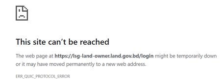

Hi,
I am experiencing an issue accessing a government website, and I would appreciate your assistance in resolving it.
The website in question is:
https://lsg-land-owner.land.gov.bd/login
Previously, I was able to access the site without any problems. However, it has recently started blocking me when I attempt to log in. Interestingly, the site works perfectly fine when I use my mobile data (O2), but the issue only occurs when I use my Virgin Media internet connection.
I have already checked the website on VirusTotal, and it appears to be clean. Could you please investigate why this site is being blocked and confirm its current categorization?
This matter is urgent, and I would greatly appreciate your prompt attention to it. Please let me know if you require any additional information from my end.
Thank you for your support.

    • Suleman's avatar
      Suleman
      It doesn't work for me. See the error message:
      See the results:

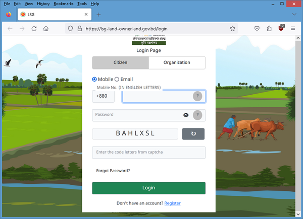

      • Matthew_ML's avatar
        Matthew_ML
        Hey Suleman, thank you for reaching out and a warm welcome to the community, we are sorry to hear you are having some website issues.
        Did any of the advice in here help or are you still needing some support?
    is working for us with VM Parental Controls disabled and VM Virus Safe enabled.
    Disable Parental Controls in the VM Online Account or use any Public DNS as a workaround.
    lsg-land-owner.land.gov.bd is not at VM Internal IP [81.99.162.48]
    your access is being blocked by the VM DNS returning a false IP.
