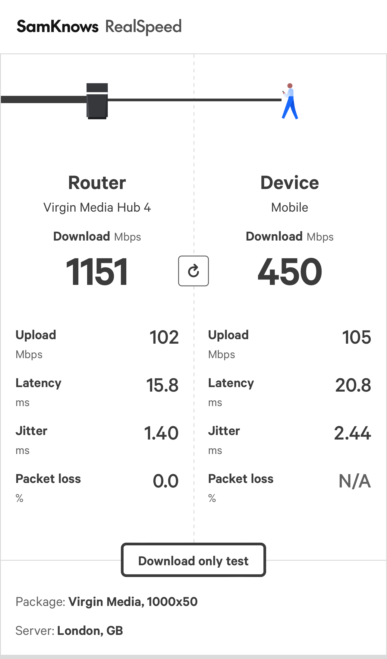

      Looks like the router is getting the speed I am expecting. To the hub but not beyond.
      on the current patch cables I’m getting g below, will see if the new cable makes a difference .
      Ps5 plugged direct 777mbps
      deco mesh, plugged  direct 668mbps
      Still not able to see in vm connect or through 192.168.0.1 after entering the password I just get a white screen.
    Realspeed test is fine, the 450 Mb/s is more than plenty for any Wi-Fi device !
