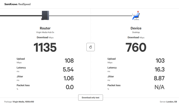

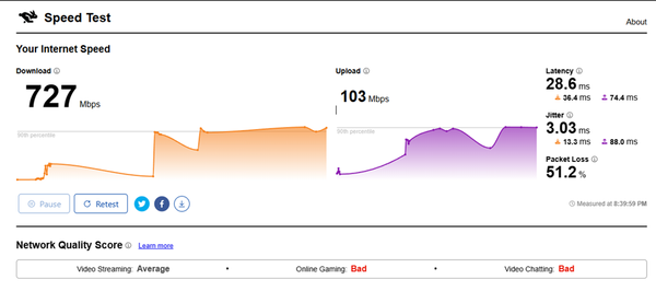

VM 1 Gig unusable for anything but Browsing and downloading.
Hello
Since having Virgin installed I am unable to do anything but browse the internet and download games. I cant Voice chat with Friends, Cant Play any game due to Jitter and packet loss.
I am Wired into one of the black boosters unable to wire directly into the router, this happens on Wireless as well. I cant seem to get to the bottom of the issue.

        Your VM connection to the Hub is worling well, according to the test you posted. But the black extender (it's not a booster as such) is operating on WiFi from the Hub. So even if you are wired to the extender you will not get a stronger signal than it is receiving over WiFi.
        I would suggest that you move the extender to a location where it is getting a stronger more direct signal from the Hub, even if this means a longer ethernet cable to your laptop or other device your are using.

    Hmm one show over 50% packet loss the other none...which do a believe?
    Your problem is bad WiFi get a better wifi router with 1Gb ports or better
