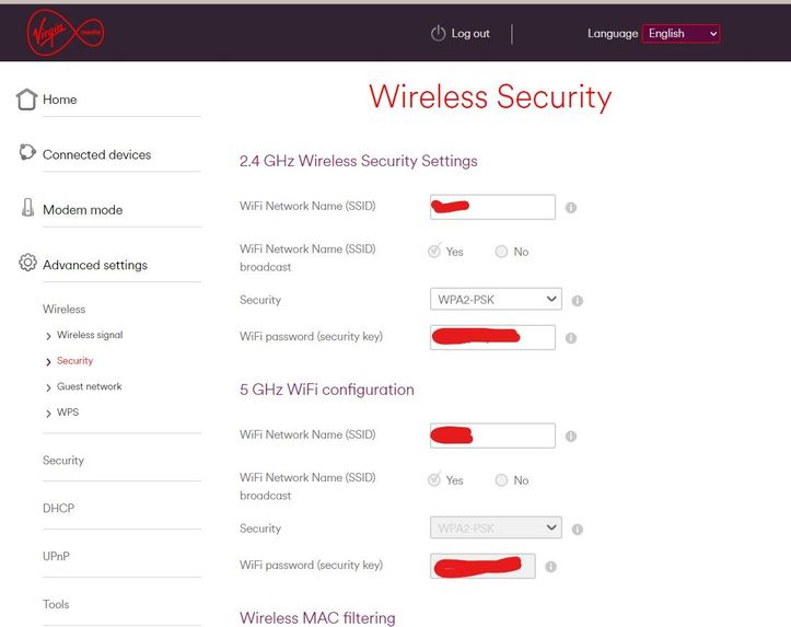

Virgin Hub 3 - Not showing all SSIDs in setup mode
Hi,
I've got two SSIDs setup in my hub but when I log in, it only seems to display my original one. I set this up possibly 5 months ago and I'm sure I could see them both previously. The wifi is working fine, but it's strange I can't see both.
It's definitely not set up as guest (I don't have this active) and I can't find a way to select the 2nd SSID. I know it should be there because it's the one I use on all my devices.
I do have some TP Link Decos attached which I use for the SSID I can't see so mayne I need to log into something for that instead?

    On the Hub 3 page shown there are boxes one for the 2.4GHz SSID and a second for the 5GHz SSID.
    At the moment I assume both are set to the same value.
    Change one of the SSIDs to be the additional value you expected the Hub 3 to provide.
    Then scroll down and click on "Apply Changes".
    In a couple of minutes check in your phone's WI-Fi settings to see if both SSIDs are present from the Hub 3.
    After creating 2 SSIDs avoid using the VM Connect app as it will pester to reconfigure the Hub 3 back to a single SSID.

    I can see both the SSIDs all the time in my phones settings, I just can't see them both in the Hub.
    By changing the name within the hub, won't that then change the actual SSID rather than display the one I want to see?

      I can connect to either for WiFi and they both show up when searching WiFi signals etc. So in that sense, they both work absolutely fine. It's just when I log into my hub, only Skimmer is showing. So if I want to make changes to Skimmer New, I can't view it anywhere.
    At this distance I can only imagine a couple of options ...
    1) the VM Hub 3 is broadcasting 2 SSIDs but only 1 SSID is listed in the menu.
    ( I have not seen our Hub 3 do this )
    2) There is a Wi-Fi Repeater / Powerline Extender / Wi-FI Access Point broadcasting one or both SSIDs.
    If the Hub 3 is switched off,  does none or one or do both SSIDs  vanish ?

      I have a Deco m4 system which piggy backs off of the virgin hub. That's what I connect my devices to. My ultimate aim was to connect another (non Deco m4) extender to expand my wifi further into garage. It was upon logging into Hub that I noticed only Skimmer was showing and not Skimmer New, despite them both working and broadcasting.
      In the scheme of things, it won't cause me an issue until/unless I ever want to change the password for Skimmer New but I just thought it was strange that I couldn't even see Skimmer New to see settings applied.

    The Deco m4 system is broadcasting the additional SSID.
    Connect to the Deco system to manage its Wi-Fi configuration - refer to the Deco installation manual if needed.
