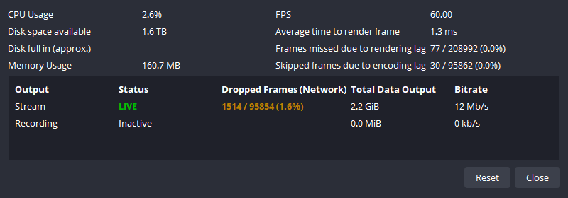

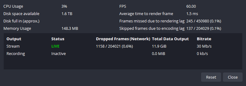

    These are network stats from OBS from when these dips occur. These sets of streams were on Router Mode with the PC and the Hub being directly connected with Ethernet.
