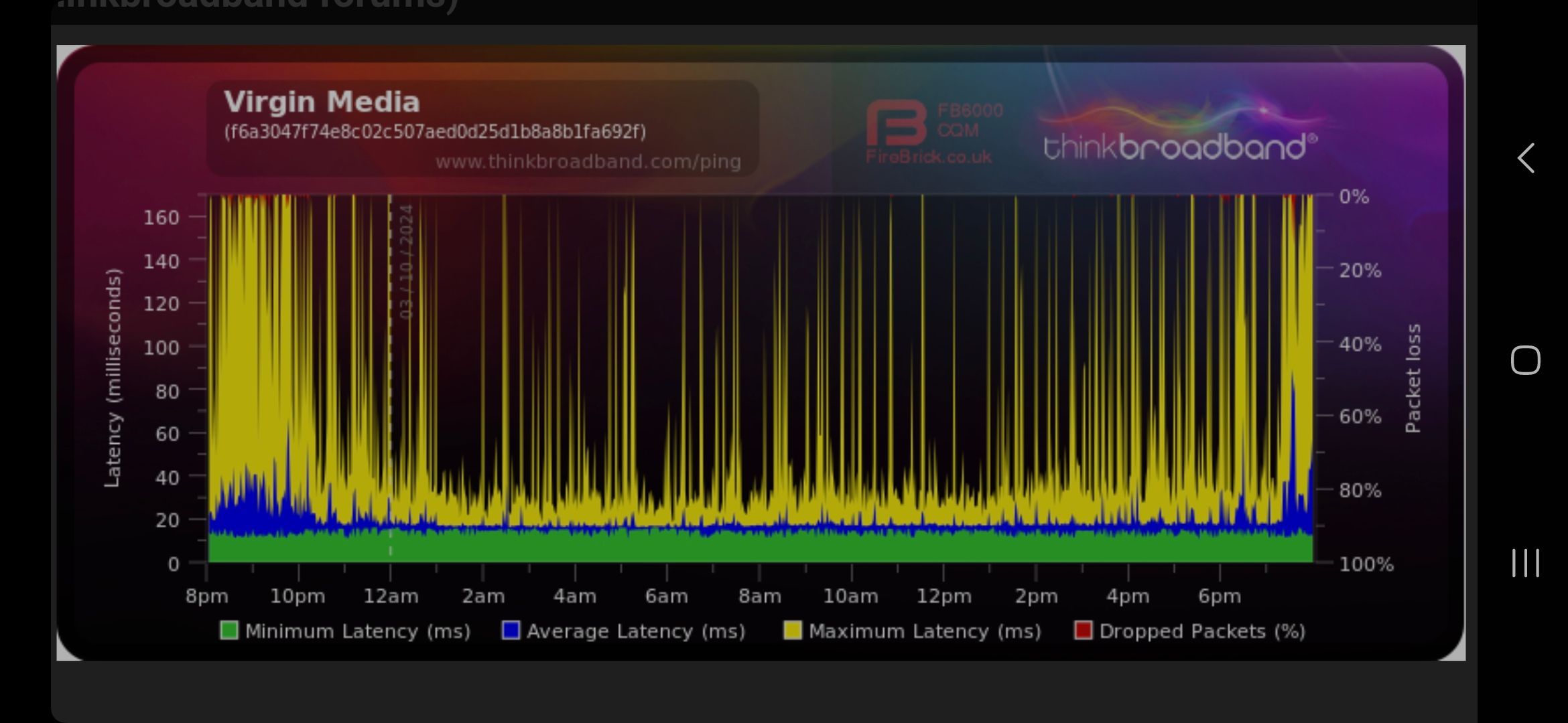

Hope it's OK if I add my problem here as well - I didn't want to start a new identical thread, apologies to OP and mods if this against rules. Have been having the same for quite a few months now.
Thought the culprit was my poor wifi, but if anything things have got worse since installing a wired connection from the router downstairs to my main computer setup. During the daytime the connection seems to drop for 5-10 seconds on a semi-regular basis, sometimes every 15-20 mins, other times far less frequently. Main symptoms are video calls freezing and streams reverting to 160p for a few seconds before returning to full resolution - all over direct wired connection to the router.
My SQM seems to evidence this with persistent dropped packets between 0800 and 0200. Reaching the stage where I would not renew with Virgin at any price unless resolved.
Any help or advice appreciated.

    Maybe something some where needs a reboot but do that to your own hub and router and stuff if using.
    Or noise by someone turn there hub on and off at the time packet loss stops
    • sneezealert's avatar
      sneezealert
      Thanks. You can probably see on the graph the time last night where I factory reset my Hub!
      Experience unchanged last night unfortunately, except for the packet loss continuing through the night instead of stopping for a few hours while asleep.
        sneezealert
        Was a bit painful, but arranged an engineer visit via live chat this morning. Hope they can work out what is going on.

  • Engineer just visited. Very friendly guy, said there was some corrosion in the street cabinet on my line and a lot of my channels weren't working correctly. He replaced some of the connectors in there.
    Hoping this will have helped out, but will monitor over the next few days to see if the problem continues.
    For the benefit of any other readers, here were the problems that caused me to log the issue. Separate graphs as I experimented between Hub 4 Router and Modem modes to ensure my own equipment was not at fault:
    My Broadband Ping - VM Modem ModeMy Broadband Ping - VM Router Mode
