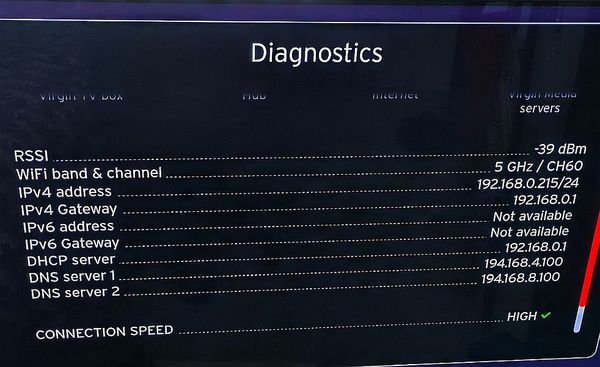

        Some images for the other parts in case someone else hits this problem.

    I have a V6 not a TV360, but I have never used VM DNS servers. I use Cloudflare encrypted servers, HTTPS (DoH) and CyberSecure Enhanced by Proofpoint and Cloudflare with no problems at all.
    TV360 DNS servers from Settings >  System > Diagnostics
