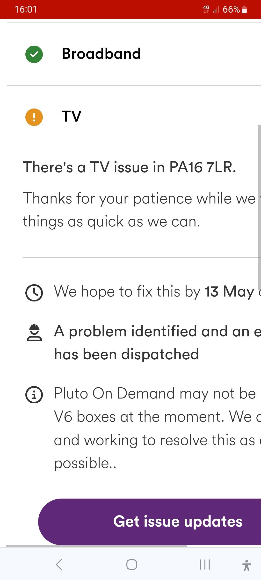

      Hi John, I have just called and it says no issues with TV, Broadband. Tried using the online and as before it is still say No issues with Broadband and Phone but TV still down and the issue will not be resolved till the 13th of May. See screenshot(s) from mobile. Strange why when you call it says no issues but online it is showing. Again thanks for replying. Cal

      Thanks for taking the time to reply. As mentioned engineer is due today so will need to wait for what may be wrong. I have also asked for status updates on this issue by email and the latest reports they are on it but it may not be resolved till the 13th of May!. I have also just repeated powering of Hub, removing power lead and coaxial and it still the same. Also repeated with box and still the same... I will now wait for engineer to arrive and get back with his/her findings. Thanks Cal
