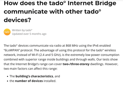

    Cant answer this but others on here will be able to - but I suspect the reason lies in the tech spec below.
    VM does not support IPv6 (only IPv4)
