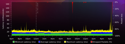

Hi. Simply gonna link previous threads of us having the same issue as it's once again back. Exact same thing. I've given it nearly a week to stabilise but more days than not, T3 timeouts are occurring once again. Our entire line from cab to router is less than a year old due to an RG11 (mentioned in the threads) and new lines + splitters from router to box. Highly doubt it's a problem with us specifically. Fault line and service page not reporting any issues thus far.
I also need an engineer pronto to also fix power levels since it seems network have recently done something that's put them out of balance, along with a reportedly faulty firmware update(?). If we have the 6dB attenuator in the back of the hub5 then Upstream is slightly too high (around 50dB) and Downstream 3.0 is fine (+3-4dB) but 3.1 PLC is bordering on too low (-5dB sometimes). Without it however, we're in spec on 3.1 and Upstream but 3.0 Downstream channels are bordering on too high (+9-10dB). I've currently left it out to make sure Upstream noise is not amplified by being out of spec. No change, however. This is not the cause of the noise issues (as proven by all 3 occasions below) but probably isn't helping. That way I can talk to them about this issue more in-depth too.
Not amused, VM. 3rd time we've had prolonged issues with this in less than 2 years. Can put up with a bad day or 2, it happens. Not your fault. Sadly it's never just that. It's potentially weeks every time without a solution which ends up boiling down to a network issue or 3 being eventually found and fixed.

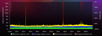

    SerenayaXIV
    For context, this is today with evidence of what's actually happening according to the log. Looks very much like network to me, or something's happened in the cabinet as I'd mentioned at the top of the thread. Again apologies for having to cancel the appointment though I did wish to reschedule, but neither the app or desktop site would let me do so, but rather simply returned a "sorry, we can't run a test right now" which is... not what I wanted to do. Cancellation was the only option that worked.
    31-05-2024 18:35:40noticeCM-STATUS message sent. Event Type Code: 16; Chan ID: 41; DSID: N/A; MAC Addr: N/A; OFDM/OFDMA Profile ID: 2 3.;CM-MAC=**:**:**:**:**:**;CMTS-MAC=**:**:**:**:**:**;CM-QOS=1.1;CM-VER=3.1;
    31-05-2024 18:33:31criticalUnicast Maintenance Ranging attempted - No response - Retries exhausted;CM-MAC=**:**:**:**:**:**;CMTS-MAC=**:**:**:**:**:**;CM-QOS=1.1;CM-VER=3.1;
    31-05-2024 18:33:31critical16 consecutive T3 timeouts while trying to range on upstream channel 8;CM-MAC=**:**:**:**:**:**;CMTS-MAC=**:**:**:**:**:**;CM-QOS=1.1;CM-VER=3.1;
    31-05-2024 18:32:23criticalStarted Unicast Maintenance Ranging - No Response received - T3 time-out;CM-MAC=**:**:**:**:**:**;CMTS-MAC=**:**:**:**:**:**;CM-QOS=1.1;CM-VER=3.1;
    31-05-2024 18:14:55noticeCM-STATUS message sent. Event Type Code: 16; Chan ID: 41; DSID: N/A; MAC Addr: N/A; OFDM/OFDMA Profile ID: 2.;CM-MAC=**:**:**:**:**:**;CMTS-MAC=**:**:**:**:**:**;CM-QOS=1.1;CM-VER=3.1;

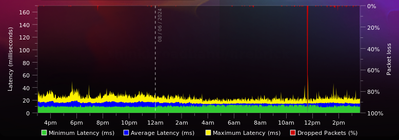

    For the record this is what it looks like right now and this is a "better" day after being clear for most of the last week. Doesn't look like much but it affects my particular profession quite a lot especially when there's timeouts involved. Are there any reported issues even small-scale? Unsure why this keeps happening on a weekly basis now.
