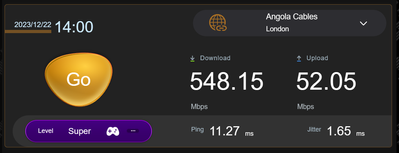

      here is an example of speed test done directly at the modem, hard wired with cat 6 cable.  Tested on multiple machines and devices.

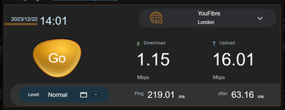

      This is my normal speed with nothing downloading
      As soon as i start to download something, after about 20 seconds it drops to this and i'm downloading at about 130kbs.

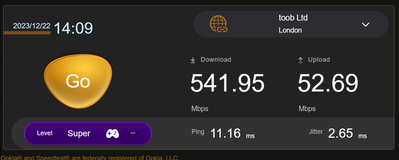

      if I pause the download it goes back to this

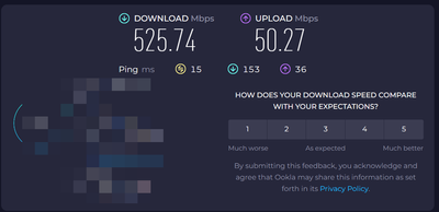

        did a test with all my equipment turned off, and just a windows laptop wired into the Superhub 3 (Cat6) in modem mode.
        Speedtest before any downloading 525.74 Mbps

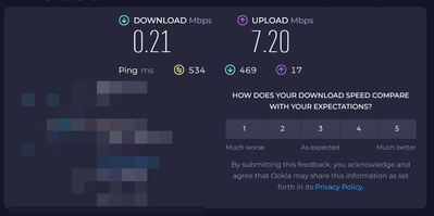

        downloaded a game from Steam Store.  After 20 seconds I was downloading at 16.7kbs, Speed test while im downloading: 0.21 Mbps

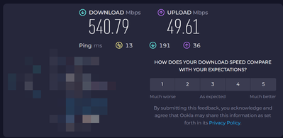

        Stopped downloading, and waited 5 mins, then took new speedtest. 540.79Mbps
