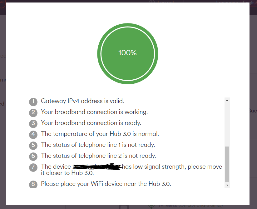

    Run the Hub 3's Network diagnostic tool
    Scroll down through the results and find the Temperature entry. Is it normal ?

      as you can see it says the temperature is normal so obviously something is wrong with the hub

        So its not overheating.   But the warning system to detect and warn you of  that "state" is not working properly.
        A bit like removing the battery from your smoke alarm detector !
    On the screen shot we don't see the temperature report.
    However if it is normal that is good news, the LED's colour is fading.
    When a Hub 3 is in modem mode the LED is magenta and that looks quite red to many folks.
