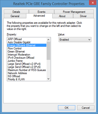

    Connect your network cable to a 1Gb/s port of the Hub 5 & you should see a 1Gb/s link rate.
    The Hub 5's 2.5Gb/s port only works when EEE Energy Efficient Ethernet is disabled on the connecting device,
    this option tends to be present on Managed Network Switches and 1Gb/s + 2.5Gb/s NICs.

      I would also double check that the following are not set to 100Mbps
      EEE Max support speedspeed and duplex
      • amadi8's avatar
        amadi8
        Thanks Dave I have this already setup as it should be. I'm waiting for new cable and I will test that first.
