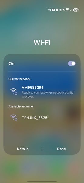

    On my phone it says:
    Current network: Ready to connect when network quality improves.
    Might be time to try a reset of the Hub 3.
    1) Press RESET for 60 seconds
    2) Keep the Hub powered on to revert to the factory settings & original passwords.
      It could also be interference from the other TP Link WiFi?  Best to set the two WiFi as one and manually manage the Bands and Channels in use.

        Thanks, I've turned off the TP Link as it's not really working at all at the moment. Will see if it helps.
